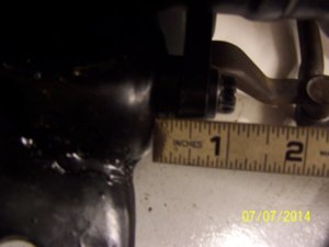

Is there a consensus how the Borgeson box needs to be shimmed? A friend of mine has the newer model in a Challenger and it lined straight up? Others reported that they needed to shim the engine side mounting bracket (2 bolts) - it seems this was the case with the older model as it pointed toward the engine (when looking from the front of the car to the firewall). The newer model of the box is apparently narrower than the old model and it will bolt up in an angle (as it was the case for the OP). If you shim the outside bracket (1 bolt) you can line up the steering shaft and input shaft in parallel but the shafts would be offset (at least for 68-70 B-bodies).
Or has anyone used a Borgeson box in a B-body and it went in straight? Would you rather get the older model or the newer model (assuming the older model doesn't leak and is properly welded)?

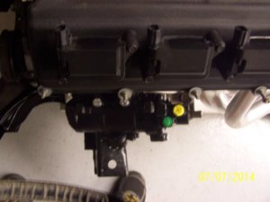

This is my set up. Not to happy with the way it looks. I've going to shim and see what happens
on my install i find the Borgeson coupler is more forgiving with the slight angle and I use lucas power steering fluid and a derale cooler with no problems, 4 years since install.
