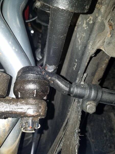

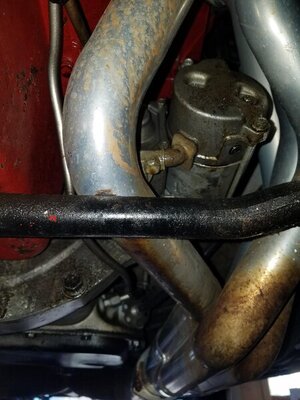

For early B poly's, headers are a challenge for clearance; but costly TTI's guaranteed a fit. Well, on my '63 Fury after complete engine rebuild by a reputable shop, come to find there are or have been clearance issues upon getting it on an alignment rack for a safety check. The cross linkage is rubbing across the header as photo'd and the left T-bar is contacting the tie rod linkage having sheared off the tip of the grease fitting. The photo shows how the t-bar has been marred from this. The latter I found when lubing prompting me to get the car put on a rack under weight to get a true look at everything. Questions? Will more clearance be had by turning up the T-bars? Or are there modified pitman and idler arms available to provide more clearance? Thanks.

You may be up against manufacturing differences on the two arms. When I first put the TTI's on my 65 w/440, there were no issues. Put a stage 3 FF box in with a new Pittman to replace what was already existing. New arm hit the tube. Had to reshape it with my two ball peens. One hitting the other. Not sure if it will change anything but maybe swap center link side to side and see if it helps. From there may have to try out some arms from different companies to see if one droops a little more. Also, try a center link from another early B to see if maybe yours got road damaged sometime in its previous life.
You've got some steering parts issues - no way the draglink should be touching the torsion bar like that.
Ron, was your centerlink removed when they did the engine work? Could it have been put back on upside down? The link hitting the header is one thing, but having an engine rebuild/putting headers on shouldn't cause the tie rod end to hit the torsion bar - they aren't related. Did this issue only arise after the engine work? Also be careful that the torsion bar hasn't been compromised by having that nick out of it - they can suddenly break if damaged. I don't think cranking up the torsion bar will achieve anything as I think it will all move as one unit, but I'm not sure. Try turning the adjuster (counting the turns) and see.
How is the passenger side ? More clearance? I would look at the pitman arm ,since that places the the drag link down away. The idler arm and the pitman arm should reach down to the same level. Motor mount sag or settlement? A few things are in play. Steering box fit correctly?

If the inner tie rod end is hitting the torsion bar he's got serious steering linkage problems - get 'em fixed and the headers wont rub.

How can TTI help with the tie rod end hitting the torsion bar? The centerlink is hitting the header, the tie rod end is connected to the centerlink. The issue is not with TTI. It's a steering issue. Contacting them is not the right answer.

Thanks Thunderlugs; your reply was the bullseye - pitman - I bought a new one from Mobileparts. Mechanic bud had it up on his lift and we noticed the cross link was lower on the passenger side than on the left. We tried to compute the reason as things 'looked' all good. He said lets get a new pitman on. That did it. Clearance is so minimal, but figured the old one wore enough creating an inconspicuous sag. Only talking less than a 1/4" clearance.
