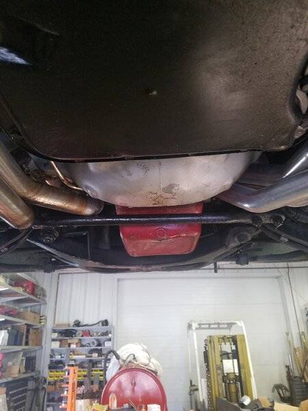

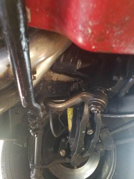

I posted while back about the steering linkage (left side only) on my '63 Plymouth striking the T-bar and header. (This is another slant on this out of curiosity, not regurgitating my old post.) The motor was rebuilt with new mounts, headers, and FFII box installed. Getting the car on a lift, we noticed the cross member canted upward slightly toward the driver side. Then looking more, the pitman lower mount looked cocked creating an upward throw on the end rod/cross link. Sure evident this has caused the clearance issue. However, has anyone encountered this? I'm getting a new pitman to see if this might be a remedy; if not likely doing a bend on it on a press to bring it more level. Thanks!

Can u post some pics. Thanks Kim
Here are two: One shows the slight angle upward of the center link on the driver's side. The pic of the pitman looks to show the lower mount is canted up causing this. Thanks

If there is no visible damage you can see, maybe put the arm in a press and take some of the bend out of it by the center link. You may be just running into an issue where the current arm is also for another application, not Mopar, that the manufacture decided to use to cut down on inventory and manufacturing differences.
Yeah - something 'changed' as Pitman wasn't replaced thru the engine rebuild and car resto. This all was fine before. My only guess is the mounting/positioning of the FF box - enough that it sheared off the grease fitting, gouged the torsion bar, and center link playing the violin on the header. Bending the arm is the likely fix, but will get a new one first and install in case this does the trick.
