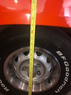

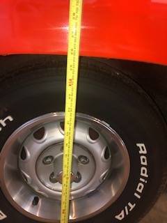

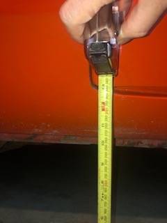

1970 Charger with 14 inch Rallyes an Radial T/A's . 25 inches at the front wheel opening, 25/4 at the rear, and almost 10 inches at the rocker seam at the aft of the door.
This is a survivor car on stock original springs with 62K miles.
Hope this helps!
Hope this helps!View attachment 1296062View attachment 1296063View attachment 1296064
