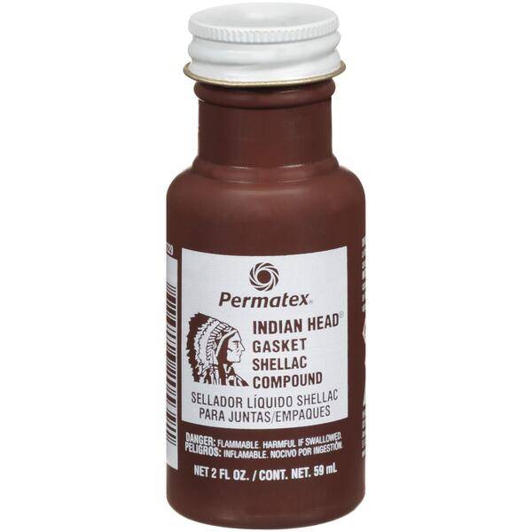

Well, just so you know, Canada (where the original poster resides) is so effing politely correct they don’t sell Indian head shellac (aside from Amazon maybe) and if they did they’d likely have to call it ‘Indigenous Head Shallac’ etc. it’s become really stupid up here and you can’t offend anyone by saying something like Indian.Aviation form a gasket is essentially, if not identically, the same thing
How about Northern Hawaiin Shellac?
