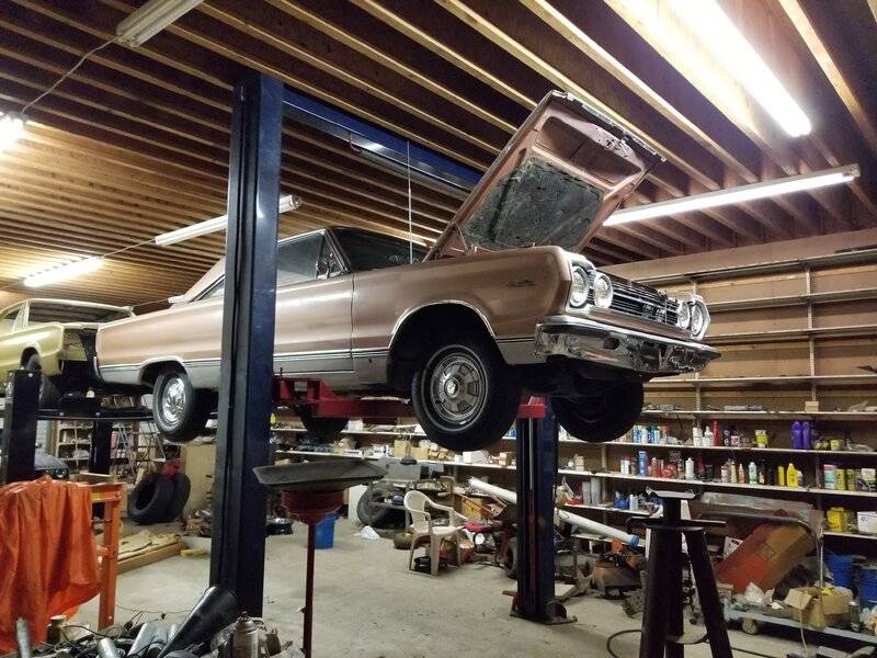

I know what to do with the rear end to unload the suspension leafs with floor horses under the chassis, but how do you guys prop up the front end?
Do you position floor horses underneath both the longitude chassis pieces or do you put 'em under the lower control arms?

Jack stands on frame rails just behind the radiator support and in front of K frame.
If you have stock rubber control arm bushings that's the worst thing you can do. If installed properly they would have been tightened with the suspension at normal ride height
Stored hanging down the rubber will be deformed/ twisted all winter. Jacks or blocks under the lower control arms is best. Why unload the suspension?
The reason for the jacks is to take weight off
the tires so they don't flat spot. Unloading
the suspension serves no purpose. You can place them under the rear axle and front A arms
with the tires just clear of the floor.
