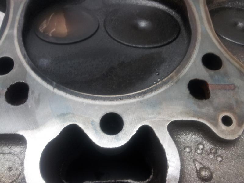

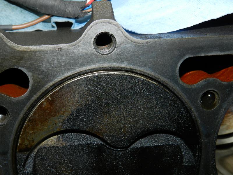

With the heads off i can see where the pistons have touched the heads (see pics), luckily nothing seems damaged.
So to reach a safe distance between pistons and heads i should use something like this: http://www.summitracing.com/int/parts/cgt-c5464-075/overview/make/dodge
Cometic gasket with 0,075 compressed thickness, maybe a bit thick but i dont want to risk it.
