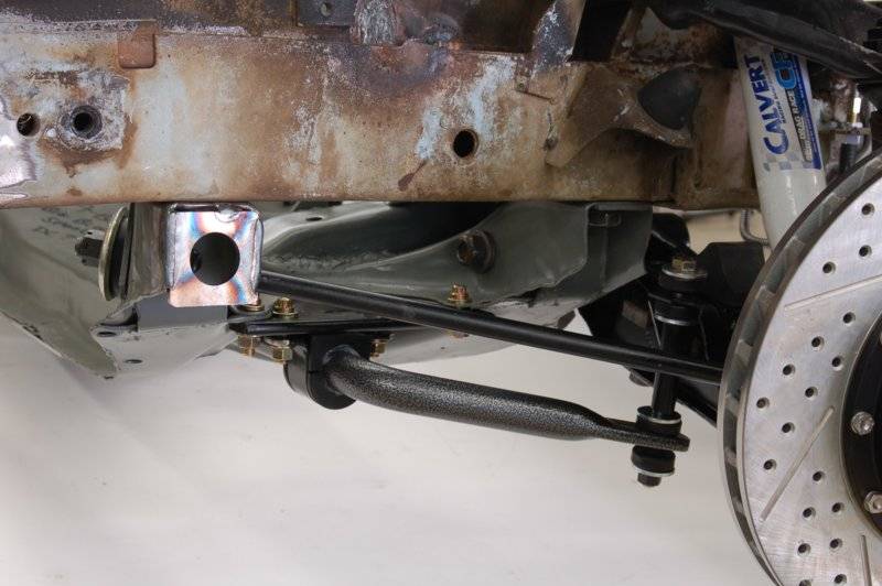

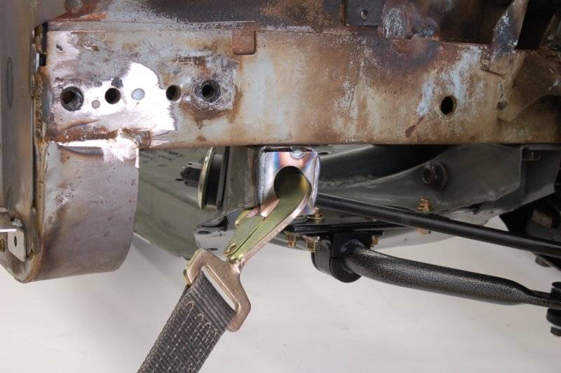

Think ahead when you build the car and add tie down points. I box the end of the K frame with plates that have a hole for a tie down. That gives you a solid place to tie down the front.

Andy,
the tie down point looks nice but it is still a no go to tie down the car on a trailer (in a garage, yes). Never ever tie down a car on anything that is sprung - always on unsprung parts (tires, axles)! If tied down on a sprung part the hook/strap will put massive strain on the part and strap and can actually break/tear it when going over a bump! The suspension acts as a dampener/shock and the chassis must be allowed to move.

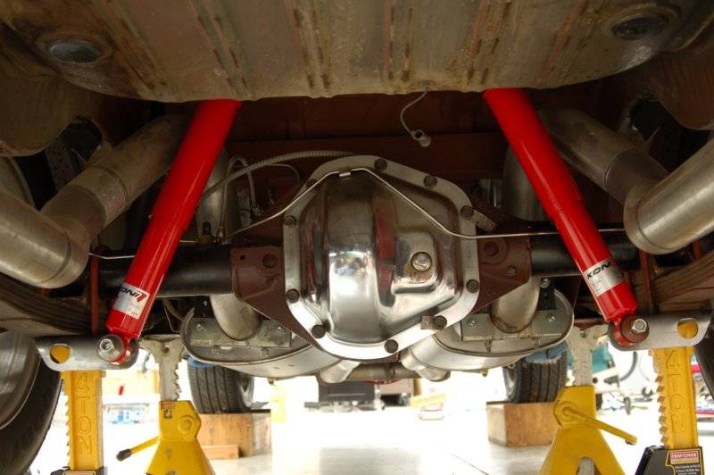

Easy to add a bracket under the shock plate. Also easy to weld loops on the K frame. If not go around the leaf spring in front of the axle housing and use the strut rods in the front. ALWAYS cross tie. As far as not attaching to the body. Most race shock manufacture recomended tieing the rear of the body down on a solid stop (jackstand, wooden block, etc) to keep the shocks from occeslating durine the tow. My experience has been towing drag cars since the mid 80,s. Thousands of miles towed.

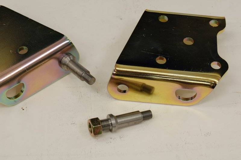

I put a tie down hole in the shock plates that I make for Mancini Racing. That makes it easy to strap down the rear axle.
