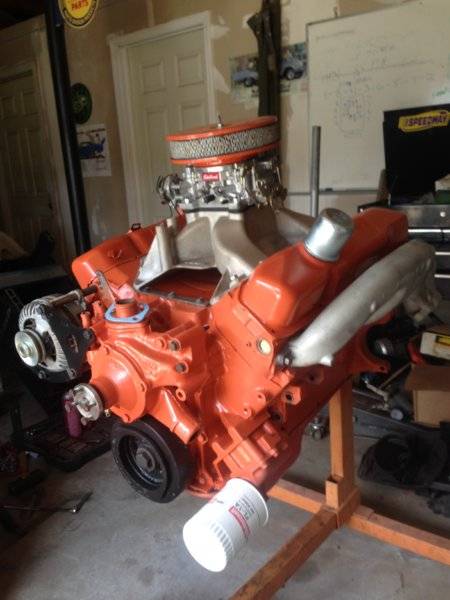

Here is my 440 with VHT Hemi.

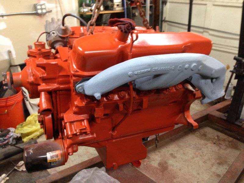

This picture is of a 383 that I repainted. However you can see the color difference between the 2 paints. Side of the block is what the VHT looks like the other more orange stuff may be duplicolor.

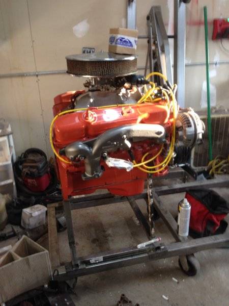

This is my 440 Little difference in lighting. More natural light hitting the front. This is VHT Hemi.

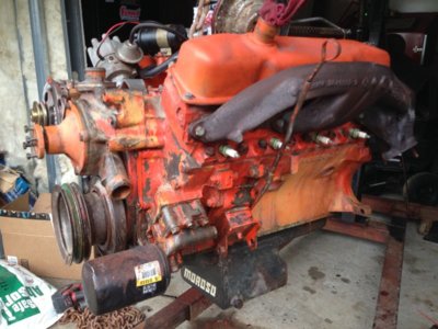

This was the 383 before. I think its the duplicolor. The orange on the back side of the block looks like that chevy ****.

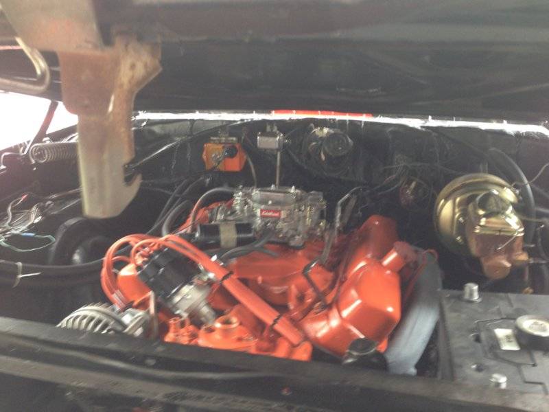

Repainted and installed in the roadrunner.
These calve covers are painted VHT the heads are a weird orange.. Could be the chevy orange. This is why i pulled the engine and made it all one color.
