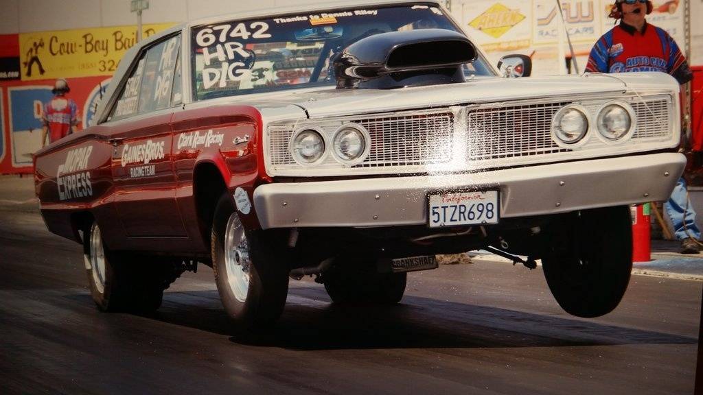

My Coronet is 100% street legal...current California Tags and insured with Hagerty.
M/T ET Streets (DOT legal) slicks.
It runs 10.30's at 129+mph in the quarter mile at the track. Looking for 10.20's @ 131mph at the upcoming California Hot Rod Reunion Race at Famoso (Bakersfield).
I drive it to local car shows but that's about it.
Don't know if I would run it on the deserted highways.
Might get loose at 130mph and kill me....lol.

And it would be considered a "serious" street car-even now! And I think that's the point of this thread. A little forethought & commitment and you can have a street-legal fast car. Nowadays we have access to a lot of things we only dreamt of but what it takes to turn those times hasn't changed---only our perception of it. Sure you can buy a 9-sec Demon now or maybe even a 10 or 11 sec car but, I'm sorry, those things simply lack the "character"(?) IMO of something like your Coronet or my A-body.....
