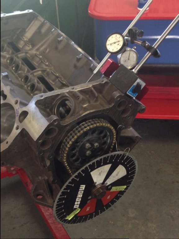

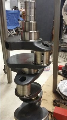

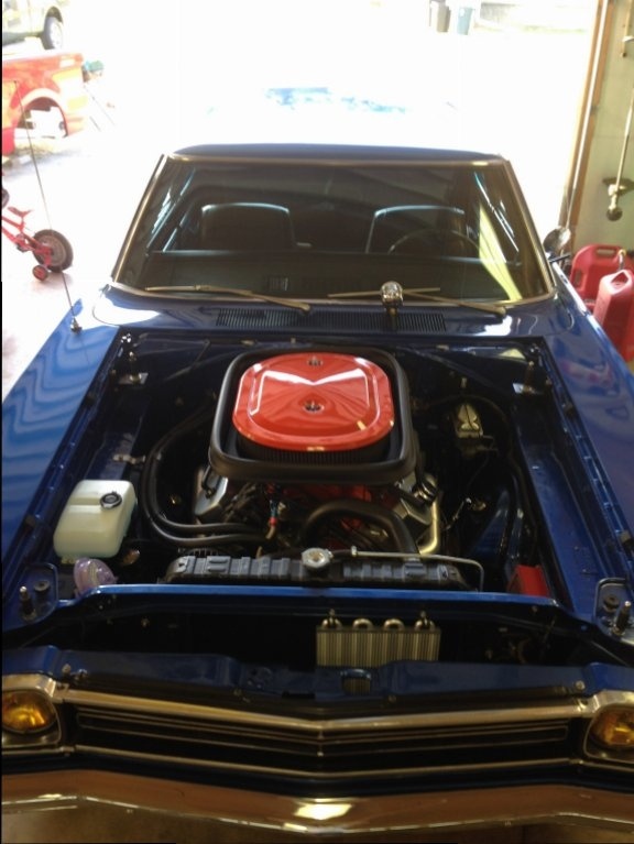

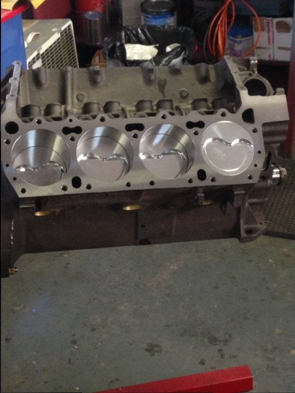

I'm using the 440 Source Aluminum Heads on the 67 GTX I purchased from 67 Satellite
I went through the entire engine with my "Bud"
PS: 440 Source is 42 miles from my house
