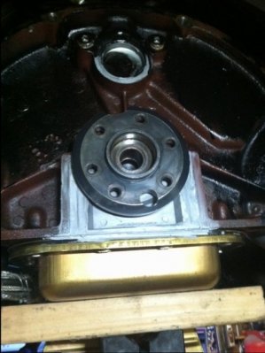

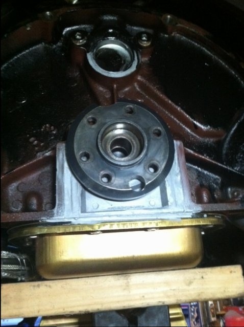

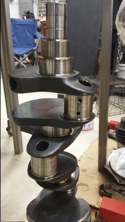

I can tell you first hand if you go Eagle pay attention to the rear main seal knurl on the crank.had a 4.15 stroker .The knurl on the crank was cut to deep and oil gets underneath the seal and leaks. seams I'm not the only one that has had this problem.
I recall reading that. Hope you got it sorted out! Thanks for posting

Hi, still leaking when I pulled the trans back its bone dry!?. nothing obvious
its the original retainer and it didn't leak previously. I've been using the same engine builder for years and he has done a few motors for me no issues, he showed me other knurled cranks compared to mine and man you can see the difference.the knurl is aggressive,a proper knurl you should just barely be able to feel it with your finger nail, this thing feels like baseball cards on a bicycle spoke rim with my fingernail :wtf: so what to do (1)try another seal, retainers ... (2) pull the motor rip apart a strong running motor and fix it propper. funny it didn't leak on the dyno or maybe we just overlooked it.
(3)Thought about putting a GZ vacuum pump on it , spoke to Bill at GZ vacuum pumps, said it would work pull the oil back cost about $800 (low inches of vacuum,about 12") an expensive remedy and a pain in the ***
(4) live with it until freshen up time. and in the meantime was thinking of putting some of them absorbent pig blankets rapped up tight at the bottom of the tranny inspection cover and change them out periodically. basically a tampon:D Hay thought about a vanity plate and it was available !! :rolleyes: hum'oily rag near the headers potential fire hazard. scratch that idea..well winters coming ,keep ya posted. peace
