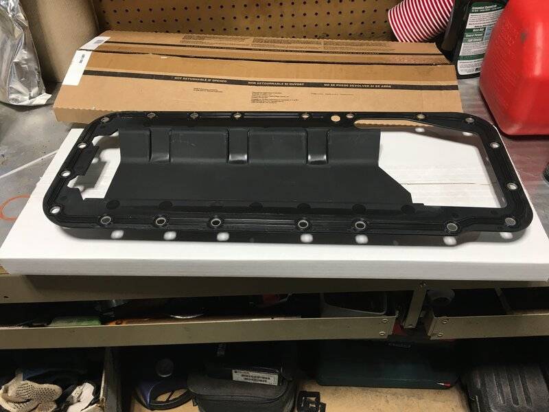

Has anyone ever used this windage tray? I’m assuming you don’t use gaskets? Or do you?

The 'gasket' is those built-in rubber seals....that said, I still smeared a small amount of Permatex #2 on them because my pan had the dimpled rails. On a pan with flat rails I don't think I'd bother with any sealer.
