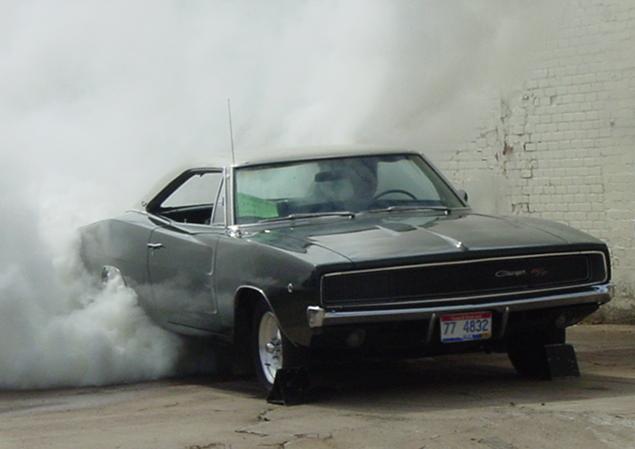

Here's some inspiration.
'68 R/T numbers matching 440 Auto with 3.55s
Last repaint was over 20 years ago... Very solid car.
