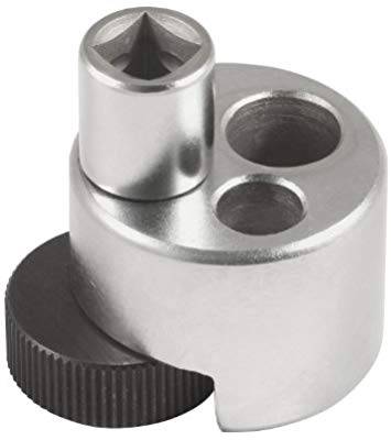

Many types out there.
I like this style. The more pressure the tighter it grips.
