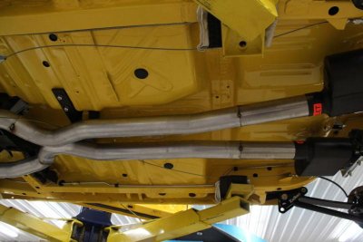

I used the XV racing ones that are weld in on my 73 charger they match the floor pans well and were nice pieces. They are marketed for pre 73' . but I assure you that they can be installed straight (beside the torsion bar cross member) and welded in.
I also ran new brake line and a new 3/8 fuel line while we were doing this.
