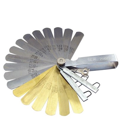

Try resetting your reluctor gap and tighten the reluctor down tight. With brass feeler guages of course. Might be all you need.
I did set gap again to .008'' with no luck....

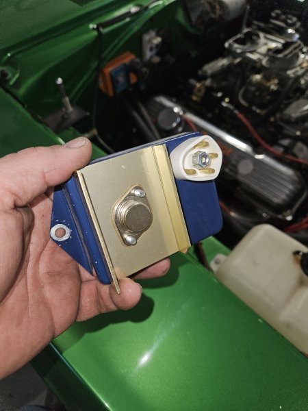

Ok... so I had a little bit of time tonight to do some investigation..... I tested for full battery voltage at pins 1 and 2 of the ECM harness and all tested well. Ballast resistor also seems good. As soon as harness was plugged into ECM I can only get about 3.5 volts to + terminal on coil. I had a new ECM and changed it out and now I can get full battery voltage at coil so I thought that I had found my problem.

Most of these I have trouble shot will give one or two quick sparks when the power is applied, regardless of reluctor position.
I hate to tell you many of these modules are dead right out of the box. Was speaking with a fellow Mopar owner the other day who had gone through three of these before he found a good one.

Thanks! It's got me baffled....

AUTOZONE
OEMTOOLS 24-Blade Combination Tune-Up Gauge
Shop All OEMTOOLS
Part #25023
SKU #1929
Total price is: 7 dollars and 99 cents.$7.99
