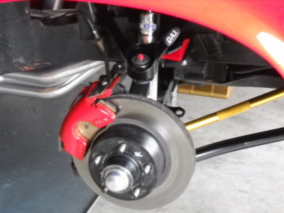

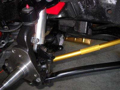

No help on the K member, but will chime in on the quality of QA-1 parts. I installed their upper and lower control arms plus their adjustable strut bars on my 63 Fury. Everything fit well, instructions were great and they made a big improvement in overall drive-ability. The powder coating is a plus...
Looks great and should provide protection for decades.
