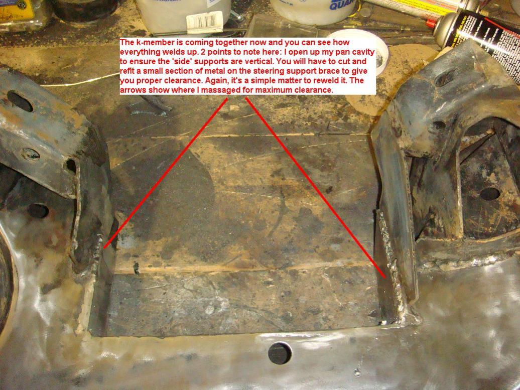

In this next shot, you can see the k-member is starting to be closed up. The side plates have been fit and are all tacked in.

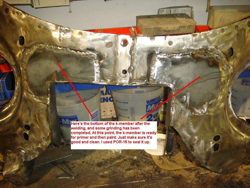

Here's a shot of the bottom side and you can see the plates are nearly welded in now. If you cut these right, they will just about flush up with the k-member as the recesses are alreay radiused.

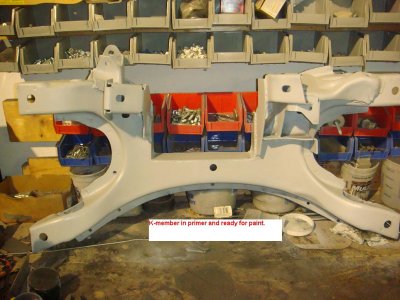

On the home stretch - prime it up for paint.

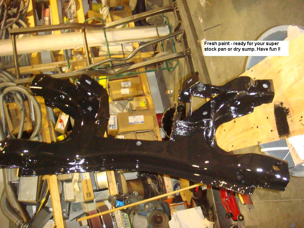

A good coat of POR-15 or your preferred chassis paint, and she's ready to go back under your hotrod.

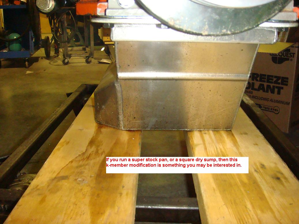

So, now, if you run one of these, or a dry sump set up, life just got much easier for you in terms of engine removal and installations. Yes, that's a 440 source SS pan, and it's very beefy.
