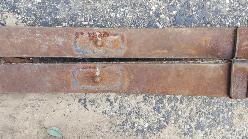

I have a Q for you guys ? I just got my rear set in and the L tire is about a 1/4" forward than the left. Both the super stock springs are mounted rite but the R pin seams to be about a 1/4" farther back ???
I have the 455 and 454 springs in a 69 runner. I have been picking my brain aprt trying to find out why ?!?!?!?
I had a Great member here bring me super stock front hangers to check my front eye location and I am dead on there ! But at a Sag with the rear out the center pins have a 1/4" split ? Is this normal ? if so why ? I know my frame is squair and so on but with the big tires on the L is hitting the lower body in the front and about 1/2" or so away on the R !
I did figure I would need to trim this ariea but WTF !!!
Maybe its the body panels as thay have been redone. I am at a loss !?!??!?
OK I just did an exact mesurement. the R pin is 3/8" farther back than the L ?
Both front eye bolts in the SS position !!!
Now what ?!?!?!?
Ok I pulled the springs out and layed them L on top of R spring with a 5/8 rod through the front eye. Now the R spring has a greater arch than the L as expectid. But when I set the top spring flats in line the R spring pin is farther back ! Now is this due to the greater arch and will they even out when fully settled ? Os is it just a pair of POS mexico springs ?
Anyone here ever run into this ?

Anyway FYI , I pulled the spring packs apart only to find the R one has the hole off to the L one. And the center bolt on the R one looked like a Noodle ( bent to crap ) when I removed it SO I hope the helps you guys who want to by new MEXICO bult SS spring look them over as soon as you get them !'As for me I bult my own set and am moving forward on the buld !

But here is a picture anyway.
