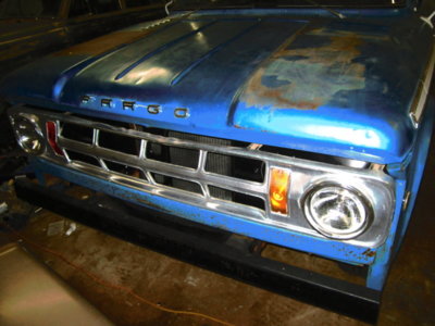

Yeah, it's for a truck, but electrons are electrons. I've got an issue with my '68 Dodge D100. Lights - I have headlights and front parking lights, but NO taillights, brake lights or turn signals (front OR back) and no emergency flashers. The tag light lights up fine, though.
So far, I've checked the connectors at the rear of the truck and found nothing loose or missing. Swapped out two new bulbs, with no results. Checked fuses, none are blown out or burnt. I have done NO wiring mods, no trailer connector wiring, and no aftermarket lighting at all. My next steps follow:

The bed would need a good ground to the frame. Maybe rig up something between the two and see if you get lights.
I'm inclined to go with bad grounds. The bumper is grounded to the frame separate from the bed, and I have a tag light. Going outside to verify whether I can create a good, new ground (or not) from the bed to frame.

It ended up being a bad bed-to-frame ground. I had headlights and park lights, and my tag light in back. Since the rear bumper is grounded separately from the bed and the tag was lit, I knew power was going back there. I took a braided ground strap, drilled a nice new hole in both the bed mount and the frame, and bolted it up. Lights are now working as they should. Thanks for the ideas.
