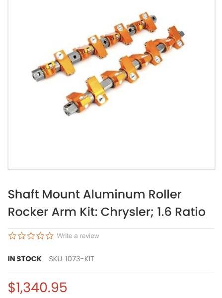

What are your thoughts?
Looking for something to put on my trick flow 270s.
I have only read good things about T&D, but there’s a used set of the comp cams for cheaper. Looks like they’re $1300+ new. Are they close to T&D?
The correct T&D rockers for TF heads will have better geometry than the Comp 1073’s....... which are HS rockers, but not the ones for TF heads.
Thanks Dwayne.
