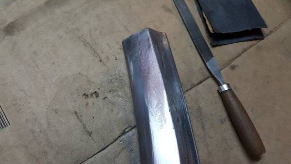

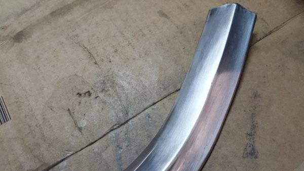

Here's a dent that I pushed back out, then took a file to it and graded up through the sandpaper grits, then polish. You can see the coating is missing. It's the best that I could do without having the whole grill re dipped.

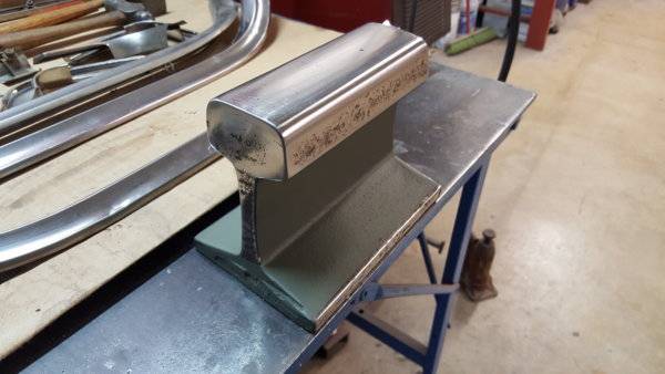

The stainless is kind of new for me as far as hammering out the dents. I'm not use to that thin of a material but I have polished it before.
I found this piece of railroad rail and always wanted to clean it up for a anvil, so that's what I did today. It should come in handy for working this trim.

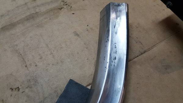

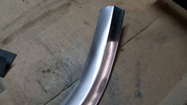

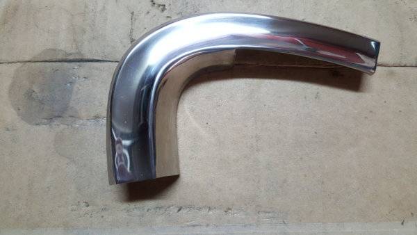

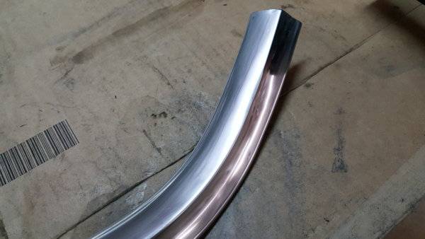

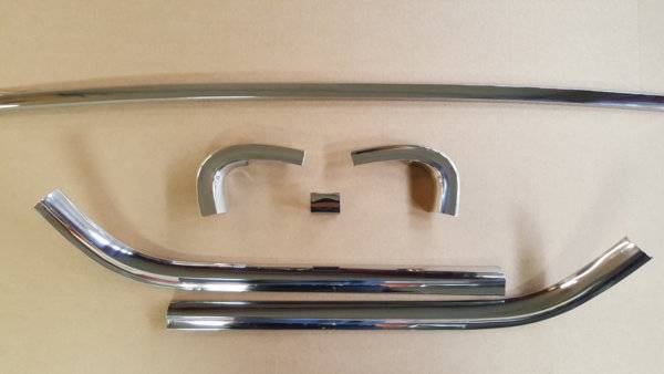

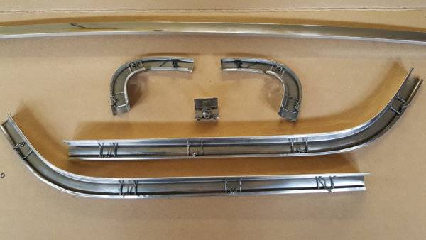

Picked out the better trim pieces and proceeded to straighten, sand and polish. This is a job for someone with a strong back and fingers!
I'll post pics in progression, hammered out dent, file, 220 grit, 320 grit, 400 grit, 600 grit, 800 grit, 1500 grit, 2000 grit.

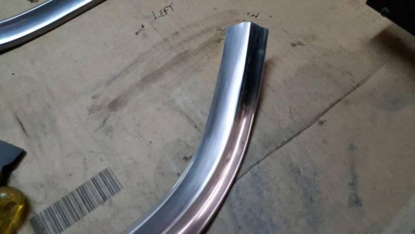

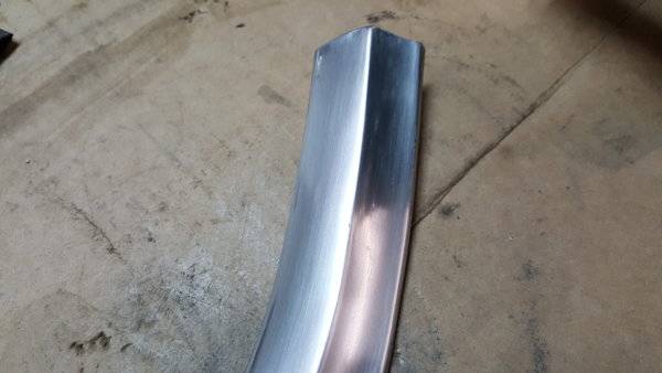

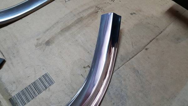

This is another piece that needed some attention.
Before
During
After
Used a wheel on the bench grinder and black Rouge first, then green. Then used green again on a loose cloth wheel.
Any scratches and there were plenty, I just sanded them out with the appropriate grit and buffed the whole piece.

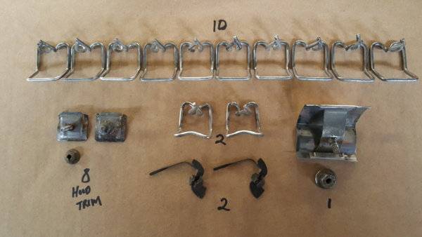

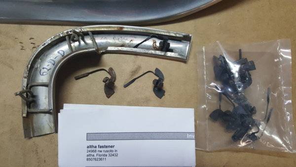

Then all of the hardware and clips needed cleaned up. Here is how many are needed. The upper curved pieces use three different size clips.
I found these on ebay. He's in Florida and I received them in two days. Great prices!

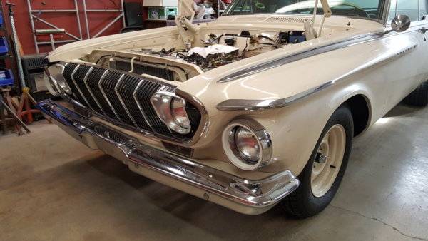

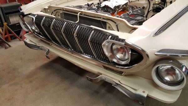

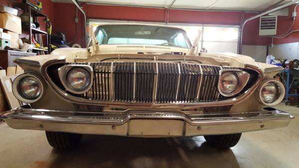

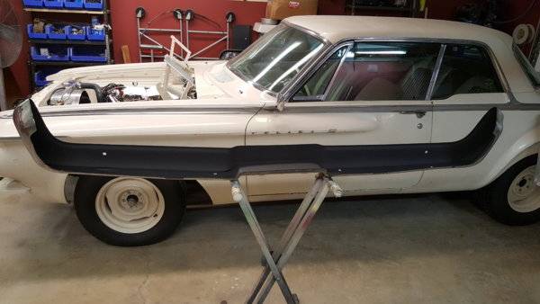

Installed all of the pieces.

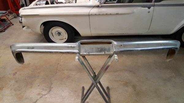

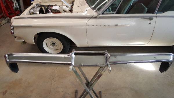

Looks like it could use a bumper.

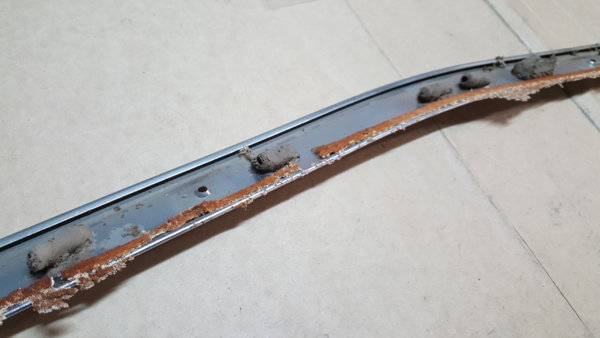

Sanded the rusty inside and coated with Rust-Oleum High Heat black.
More fkn polishing!
That's a little better. The bumper has its battle scars and it's just going to have to do. It's a "Driver" and 55 years old!
More fkn polishing!
Mr. Kid. I admire your drive, determination and perfection that you put into every piece that you touch. You did a fantastic job on that dented piece of stainless too man. Always look forward to seeing what you're up to when you post!

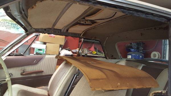

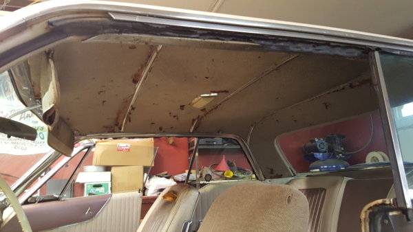

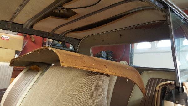

On to the headliner. (No, none of the pieces are for sale!)

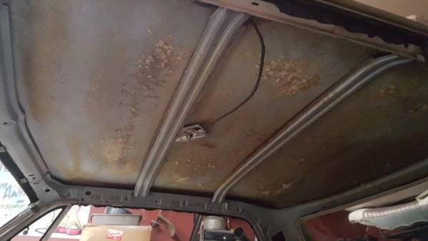

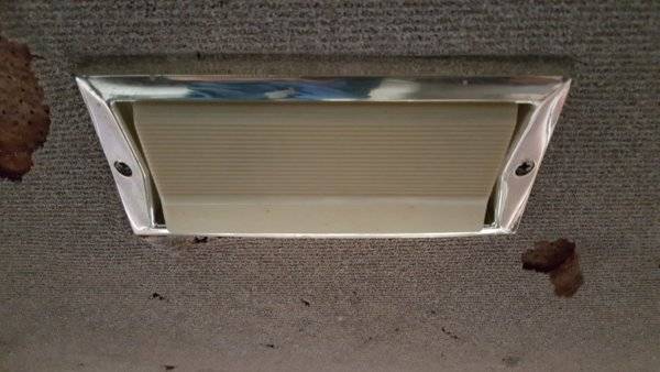

Don't know what kind of bugs make these?

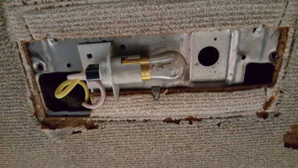

I dont know why they don't fasten the light into the frame of the roof. It's just mounted in the hardboard.

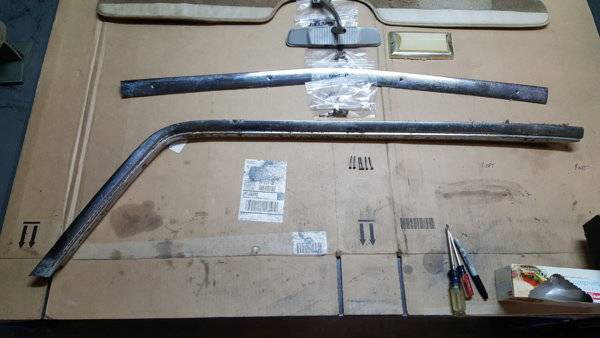

Tagging and bagging all the hardware.
Finding lots of small items and hardware.
Removing the panels from front to back.

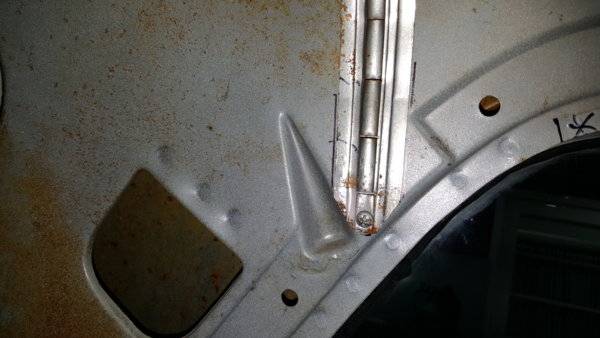

Removing the plastic trim is a little nervy.
There are paint markings for where they go.
Dome light is just easier that way! Wasn’t expected to last for more than 10-20 years!

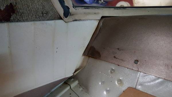

Needed to remove the rear seat and side pieces to get the last panel out.

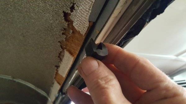

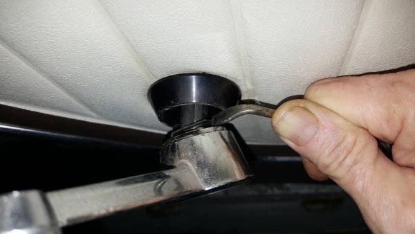

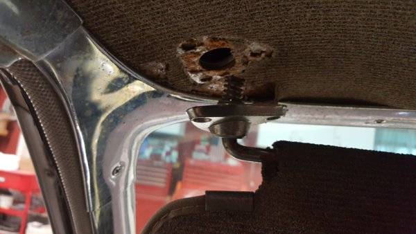

I had forgotten about these clips. Not your normal c-clips like on the newer cars.
Pry back and use a screwdriver to press the clip sideways to release the square clip from its groove in the shaft.
You can also use a pick to pull the clip to the opposite side to release.
This is how they look. Every handle is made the same so the spring is released only in one direction.

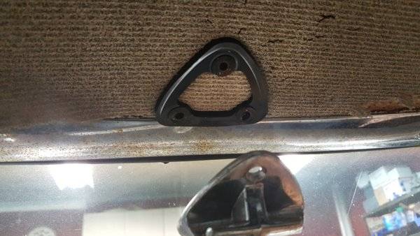

Removing the side pieces there are three clips on the leading edge.
Back to the last piece of the headliner.

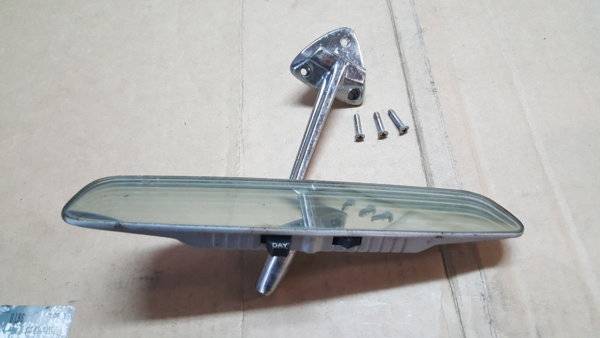

I knew I couldn't get by without finding one of these. It comes with the territory! They've been gone for many years.
Storing and organizing everything on top for now.

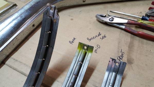

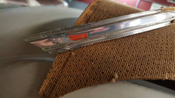

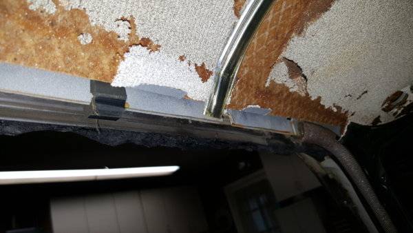

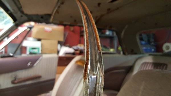

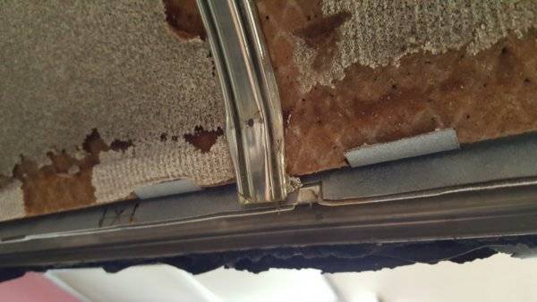

There are stainless steel straps that serve as a divider and the rail for the plastic trim to fasten to.
They are color coded also for location.

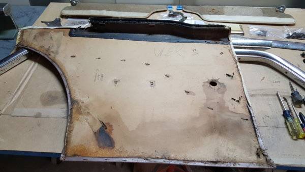

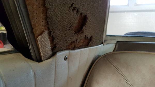

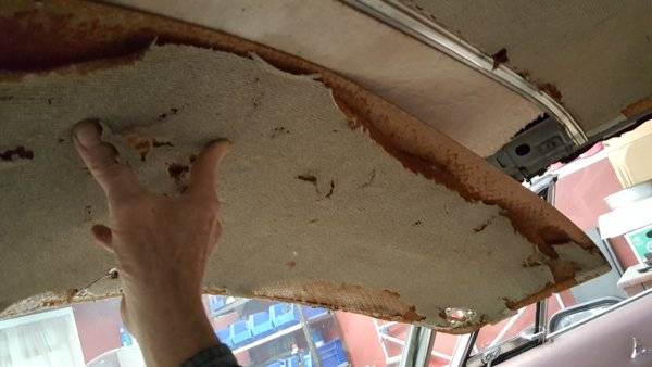

The jute looked reusable if it wasn't for the one pesky critter that had to tear a couple of pieces up.
There are notches on this side of the boards, 1, 2, 3, 4 for ID

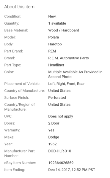

I've researched these hardboard headliners and did find that REM has them. I need to contact them for more info. Looks like they only have vinyl material for them when mine had a simulated corduroy look to it.
https://www.ebay.com/p/62-Dodge-Polara-2-Door-Hardtop-Headliner-Perforated-Wood/852099098
http://www.jegs.com/i/REM-Automotive/810/DOD-HLR-310/10002/-1
Colors available... (I'll use white if no other material is available.)
