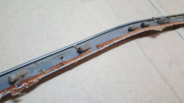

I'm still wondering what bug made those mud huts I found in the front trim.
Yellow jackets or some kind of wasps. Saw a few small nests in my trunk before.

There wasn't anything in them, not even a shell from a larvae. Another Texas critter! I say that because the dealer I bought it from was in Texas. The car spent it's whole life on the west coast for the exception of him owning it for a short time.

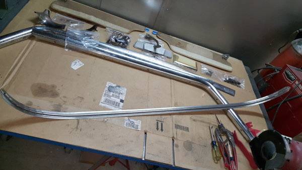

Looking good Kid ,your pictures and all the small items really help ....can you post some pictures of all these small parts so I can identify ALL that's needed?
Mud Dobbers KK. I just cleaned some off my upper house garage storage shelves. Look like wasps.

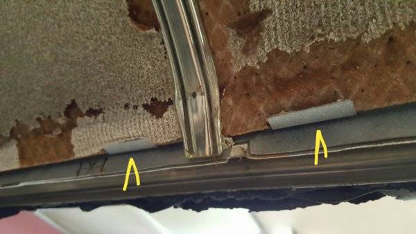

As far as parts... I'm thinking these clips are used at the front edge with either style top. Four clips.

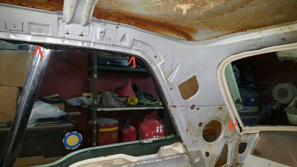

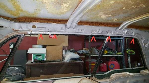

These rubber pieces were just pushed on. Location is where I made the arrows. 5 on each side.
Screws were for the chrome trim. All the same size. 6 on each side.

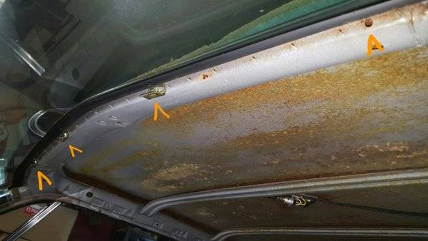

The hardboard clips were easy enough to bend down for the board removal so that's what I did. The factory installation probably only required bowing the board down in the center, hooking the clips, then pushing upwards to seat into place. I didn't want to chance bowing them.
6 clips on each side.

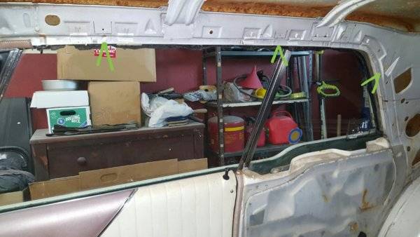

The three stainless pieces, and I use that term lightly, that divide the panels and are used to attach the plastic strips to, are fastened with Phillip screws. I've marked their location.
If these pics aren't detailed enough, let me know and I'll email you a good resolution picture. They're not that crisp on here anymore. Any other questions let me know.

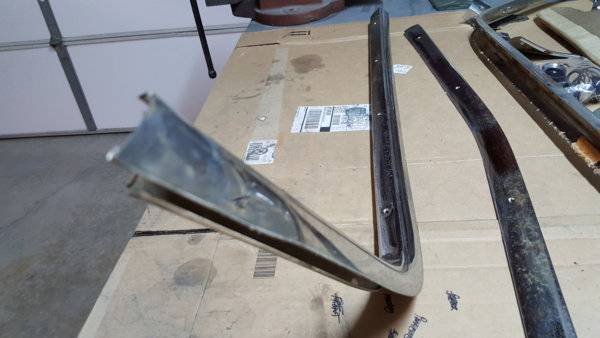

One more thing, did the bow type headliner use this style side trim?

Kid im not sure about the bow type headliner ,I would assume you would use those trims.

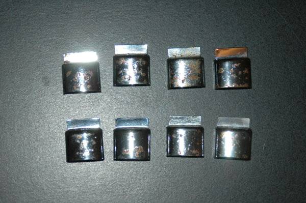

I was given these headliner end caps but I'm not sure what part they play
I'm wondering if they are for the ends of the rods on a bow style. 4 on each side? Nothing resembling that on my top.
No these where not on mine . I purchased them thinking they may have been another piece of the puzzle...turns out they aren't:thumbsup:

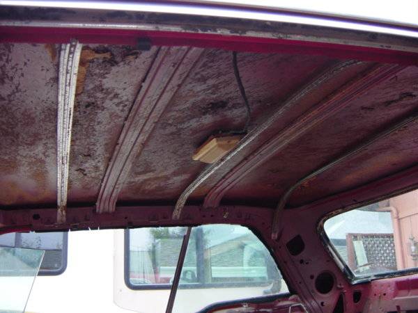

Here's a pic of the bow headliner and I can see the trim is the same, just painted. They didn't use any nickel or copper under the chrome on mine. I'm probably going to have them re-chromed.
I'm starting to believe that there was no bow type headliner for th 62's and only these cardboard type.

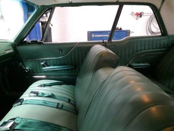

Here is a very original dart 330 ,paul from NZ
I saw that video before. Very high end interior for a 330. Deluxe steering wheel, upholstery, carpet ect. Looks like a 440 model interior. It was probably customer ordered that way.
