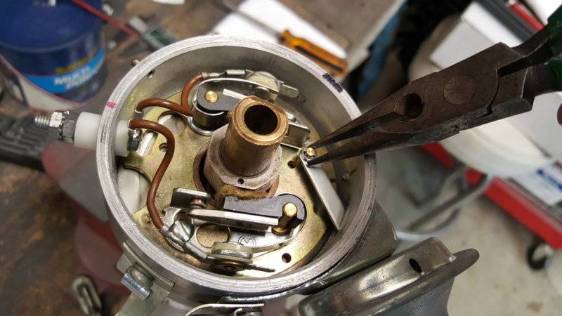

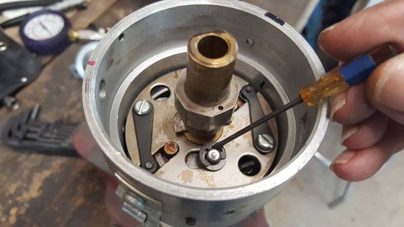

I found that the Mallory dual point, (27 series) distributor was way off in mechanical advance and also in the vacuum advance. The factory settings were at 25* on the mechanical and way past 60* on the vacume advance. This is a nos unit. Here's some documentation on how they are adjusted.

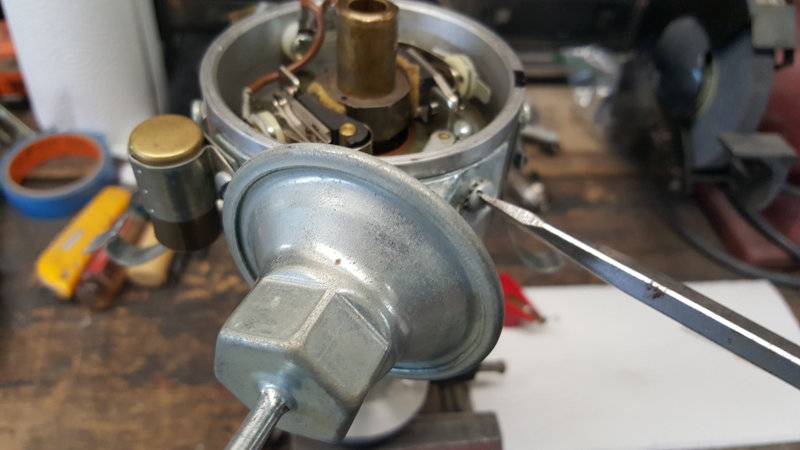

Removing the vacuum advance

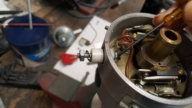

Then remove the bushing for the wire.
Then there are two allen set screws to remove. I marked the inside before removing.

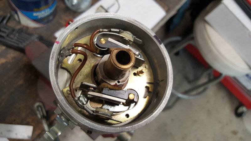

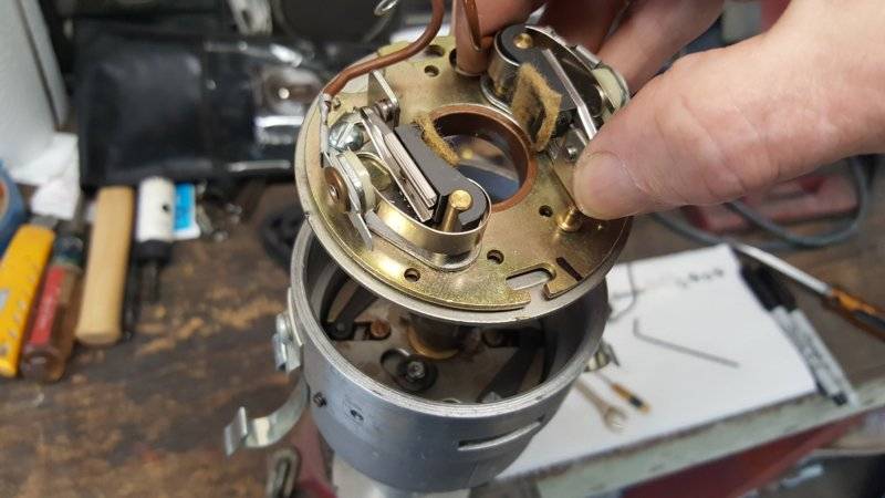

Then you can pull out the points plate
Then you remove this C-clip and pull out the lower plate.
Here's where you can change your springs for a earlier of later advance.
My problem was too much mechanical advance. With the vacuum disconnected, I had way too much with the factory setting of 25*. I'm setting my initial timing at 18* so I would like to end up with 34 - 36 "all in". So 18* from 36* would be 18*
These are the stops for the weights.

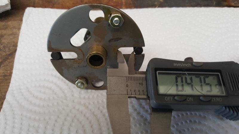

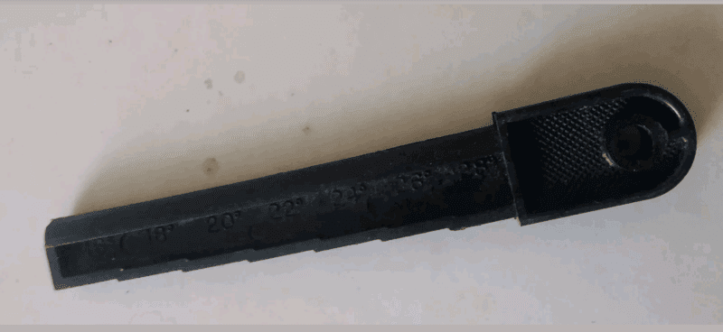

I going to set the stops at 18*. They have a plastic guage that normally came with the distributor. I don't have a guage but I did manage to find the measurements for each step in a guage.
I needed a guage to do my measuring with.I just happen to have a scale that will work perfectly. It even has rounded ends to fit the slot. I decided to go with 19* which measures .414
Here's the factory setting
I closed them up to the 19* measurement of .414
You loosen the screw and nut, move the stop inward and tighten. They are a little bit of a pain to get right on the first try. This is why they changed to tabs on the newer ones.
Reinstall everything in the reverse order.
When installing the points plate, I lined up my marks that I made and when installing the set screws you could feel the place in the plate where they once were. Takes that special touch.
Their condensers have a bad reputation. Believe it or not it still worked but I ordered two new ones. The first new one I installed went up in about three minutes. I thought I was running out of gas until I swapped it out for another one.
The hard part about finding another brand to use other than Mallory is the lenth of the wire. It's longer than most out there.
Got her all back together and the mechanical was spot on. Then the vacuum advance was still off the chart. There is an allen screw inside the nipple on the advance can. Counter clockwise takes advance out, clockwise adds advancement. I had to turn it counter clockwise 5 1/2 turns to achieve 50* total
