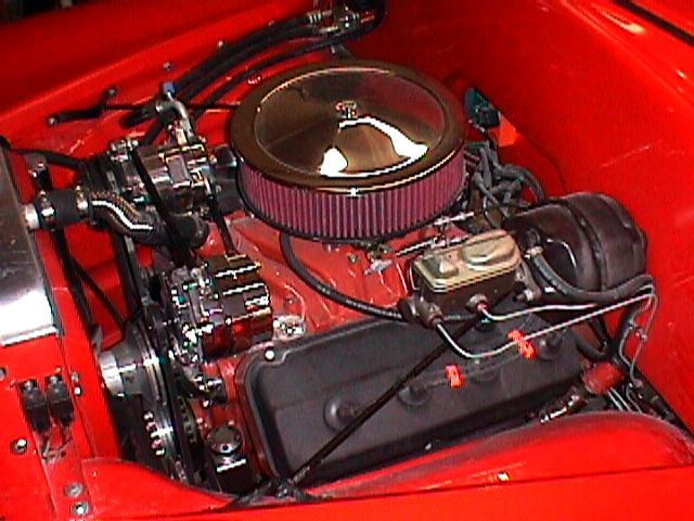

They make all different sizes of studs so if one set is a little loose you can always pick up a set that has a slightly larger base if you want. That said, I did exactly what you're doing on the front hubs of my 32 Ford highboy (.... which is powered by a 331 hemi by the way). Tack welded them in place mainly because I was too lazy to order a larger set.

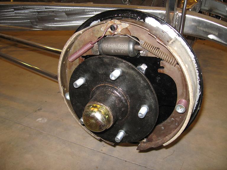

What you're looking at here is 40 Ford backing plates modified to accept mid 70's GM station wagon self energizing brakes and stock 40 Ford hubs with new studs. This is the "poor man's" way to get self energizing brakes on the front of a Deuce. The Lincoln brake kit (which basically does the same thing is over $400). The only other option is disks but they aren't appropriate for a period (early 60's) correct car.
Exactly. After I drove them in.....and very easily, I spied my mig in the corner and it was all downhill from there. lol Don't you want a spare 331?
No thanks. I put one in a '53 Chevy pickup, and another one in my Deuce. They're just too expensive to keep on building them.... two is my limit. :BangHead:
