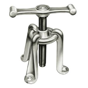

Here's the puller for the drums. As others have said, a slide hammer works well for the axle shafts.
