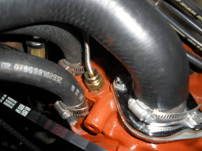

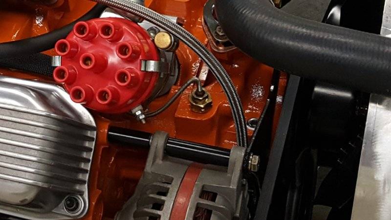

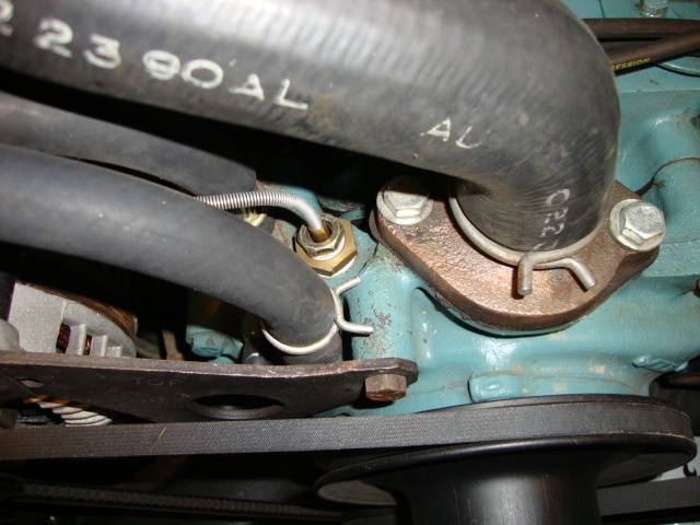

I understand I can use the heater port, but I don’t want to lose the heater function. Any suggestions?
Do you have a pipe plug in this location that you can remove? Some housings don't.

(Swiped the pics from a couple of threads on here about this topic)
If you have the sending unit in the 3/8npt port next to the alternator bracket, it will only read the temp of the water coming from the rad. this water will stay cool till the stat opens.
