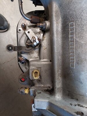

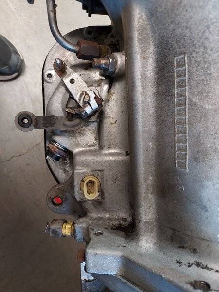

@moparmarks You’ll need the RU unless you run the computer for the RE. Can you post a picture of the side of the trans?

You'll need to verify but I'm fairly certain that all of the 42rh/500's were lock up. If the 904 converter you have is l/u also you may be good, but verify. The 42rh/500 is the 904/999 based trans with the o/d added to it. The 46/47/48 rh&re/518/618's are 727 based trans units with the o/d added. 46/518's are gas v6/v8 units, 47/48/618's were used behind the v10 and diesel applications. There are two oddball units done for Jeep applications with 5.2/5.9 engines due to the starter being on the passenger side instead of driver. One was called the 44RE which I think was behind the 5.2 and a 46RE behind the 5.9 in the Grand Cherokee Limited. All of the RE units will require a trans controller to operate. 91-93 diesel units were o/d but non lock up, 94-5 V10/diesel were lock up. The diesel/v10 units have stouter internals due to the increased torque input and would make great units to hack off the front bell housing to instal an Ultrabell so they could be retrofitted onto a big block.
I forgot one other oddball. 92-95 Jeep Grand Cherokee with the 5.2 had a 46RH. Same deal with starter on rh side.
