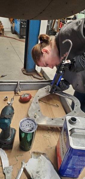

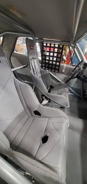

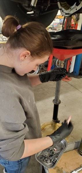

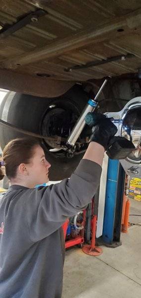

Had my granddaughter and my son working today. My granddaughter pulled the rear diff cover, installed the wheelie bar mount, polished the sill plate, assembled the Kirkey seat tracks, and helped diagnose electrical. Got it running thus Ewing. Not without fanfare. Oil pressure gauge line leaked right thru the braid.. One old carb fitting leaked. One new -10 hose end wouldnt seatand leaked. Fixed 3 minor leaks in the trans yesterday. Alternar doesn't work. Though wiring appears correct. Old Optima is junk. Then it wouldn't idle. Pulled both the carbs apart that I had done a few months ago. Rear carb passenger needle and seat was stuck shut. Retired runs nice. Need to set the crank trigger. Timing is only 26 degrees total. Adjust the oil pressure relief valve it's set about 60 psi. Still have the wheelie bar, acusump, carpet, seats, seat belts to install. Then scale it and adjust preload and shocks. Hope to test Wednesday.

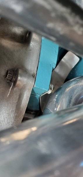

That is awesome working as a family on the race car. I have to know what that aluminum part is that is being sandwiched between the housing and the cover.
Is that a wheelie bar mount?
Gus

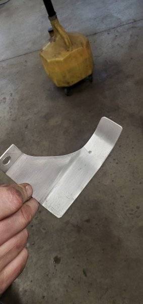

As was guessed a wheelie bar mount. This us a new style for Cal Tracs. Little stuff thar takes time. Old school style switch panel. Safety cover to activate the trans brake in reverse. Trans brakes aren't legal for N/SS. So the normal release button has been removed. A little heat shield to keep the the engine diaper off the header.

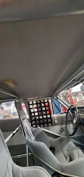

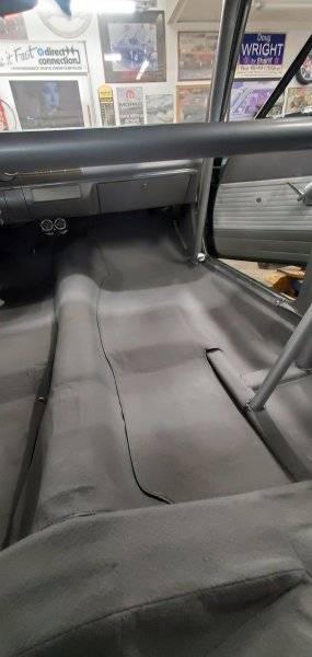

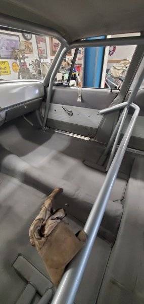

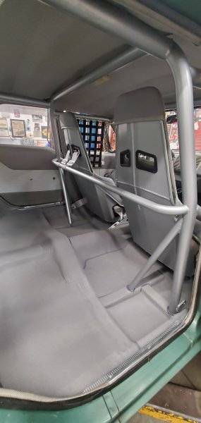

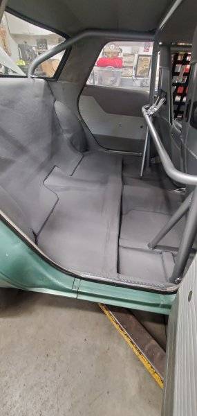

So one month to the day. Fortunately I'm retired. So a months worth if long days. My son and grand daughter on weekends and after work. Along with our friend Virginia handling the carpet. Also her and my wife making a very convincing headliner patch panel glued to a headliner with holes you could stick your head thru. Hintbits above the fronOil pressure issues the last two days, carb issues,trabs leaks all solved. Put the hood on tommorow. Scale it, set preload on the Cal Tracs and go test it out. The interior is all original 62 except seats and carpet.
