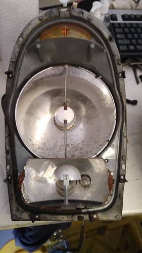

while the UN version gets everything in there... note this is LHD ( or RHT per the traffic side ) by the lense pattern ( compare with R107s posted previouslly )
sorry need to make the correction... the small lite for parking is on the road/fog lamp area for W111 ( and I guess similars like W108, W114 ) not on the low/high section... My bad.

And to make it even more complicated than that, some cars lit the front position light for the front parking light, while others had separate bulbs for the two functions. Some versions of the W111 European headlamp (the 1st-generation H1/H1 halogen units) have two separate bulbs for these two functions, for example; others (the pre-halogen R2 units you show) have just the one.

And since you show a pic of an old W111 headlamp with decrepit reflectors, check out these wizards in Germany. They do great work.
