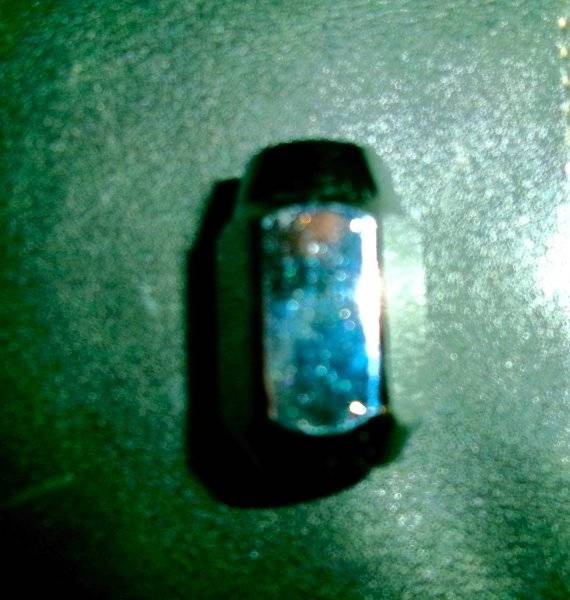

I bought a new set of Magnum wheels with center caps and acorn style chrome lugnuts. Only problem is the lugnuts are all right-hand thread. Where can I get these lugnuts (see attached pic) in left-hand thread?
I will need 10 of them.
