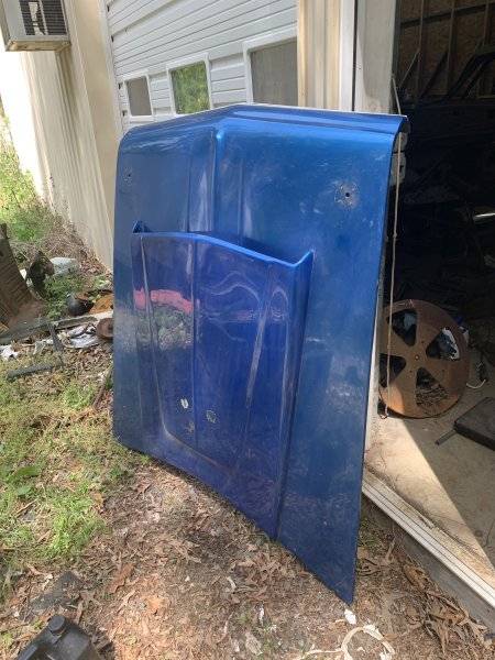

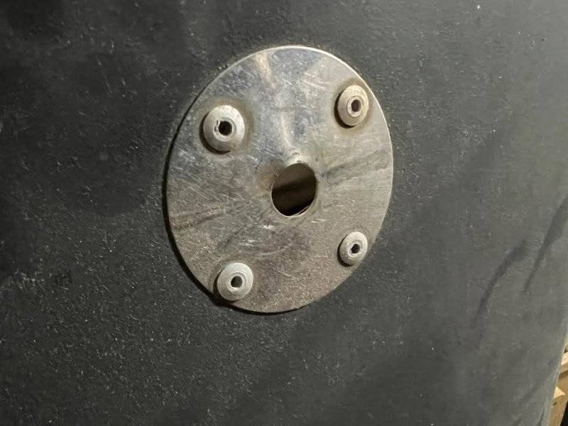

I have a fiberglass hood with Hemi scoop molded in, I’ll weigh it tomorrow. Made for hinges and 2 hood pins up front

The flat '65 steel hood weighed 79 Lbs. The surgically gutted version of that hood weighed 56 Lbs with a fiberglass "Low Mouth" Hemi scoop installed. The hand crafted all aluminum hood and "Tall Mouth" aluminum Hemi scoop comes in at a floaty 33 Lbs. A full 46 Lb removal on the top and very front end.
