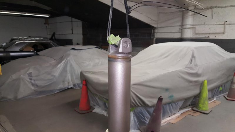

Here's the '68's aluminum driveshaft painted and patina'd to look like a fresh steel shaft complete with faked weld bead heat marks. This is at the now infamous Area 51 garage.

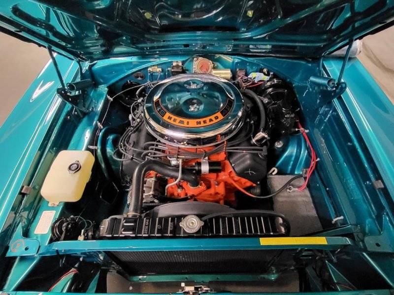

So here is the engine compartment. Nothing special other than it is nestling a Hemi. Though the mega block is heavier by a few pounds from an original block, the car was able to obtain Wedge weight stance by use of the usual suspect parts. Aluminum water pump, aluminum water pump housing, aluminum thermostat goose neck, home made aluminum alternator brackets complete with the factory dimple stamped out for good measure, aluminum intake manifold, aluminum heads, all painted Hemi orange.
Take note to the heater delete plugs and coffee can lid block off plate on the upper left firewall. Looks like something that could be factory.
The exhaust manifolds which were extrude honed by Dudek's team were relieved of a couple of pounds through the procedure which also makes them flow much better. This is a F.A.S.T class trick already out in the open for sometime now, so I'm not revealing or holding onto TOP SECRET classified information.
Suspicion is that another 20 -30 Lbs could be shaved by aluminum fender bolts, stamped aluminum anodized valve covers masqueraded with wrinkle finish black paint, aluminum air cleaner top lid, lightweight starter underneath, aluminum factory looking brake reservoir.

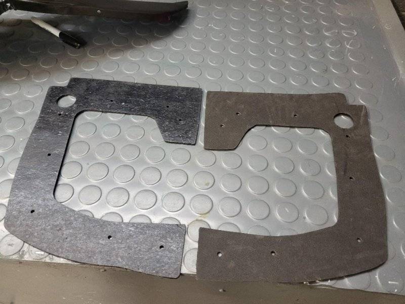

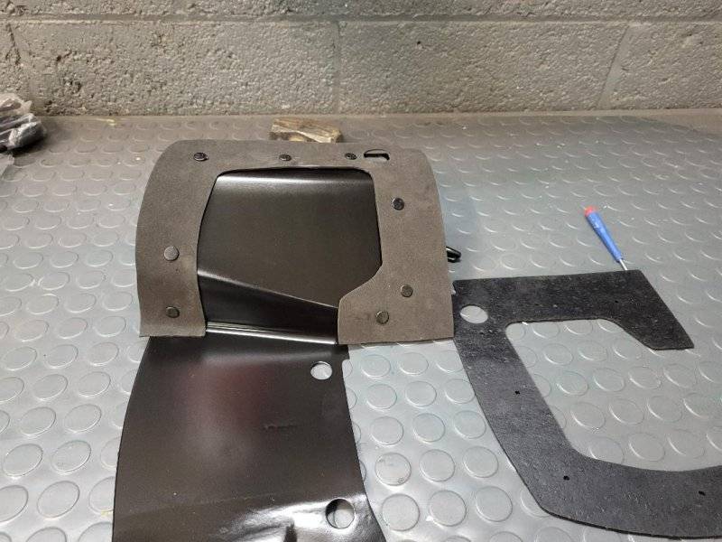

Here's a big difference in weight for the under fender rubber flap seals. The metal splash shields themselves have been chemically milled to wafer thin. The metal splash shields weigh practically nothing now from a couple of pounds ago.

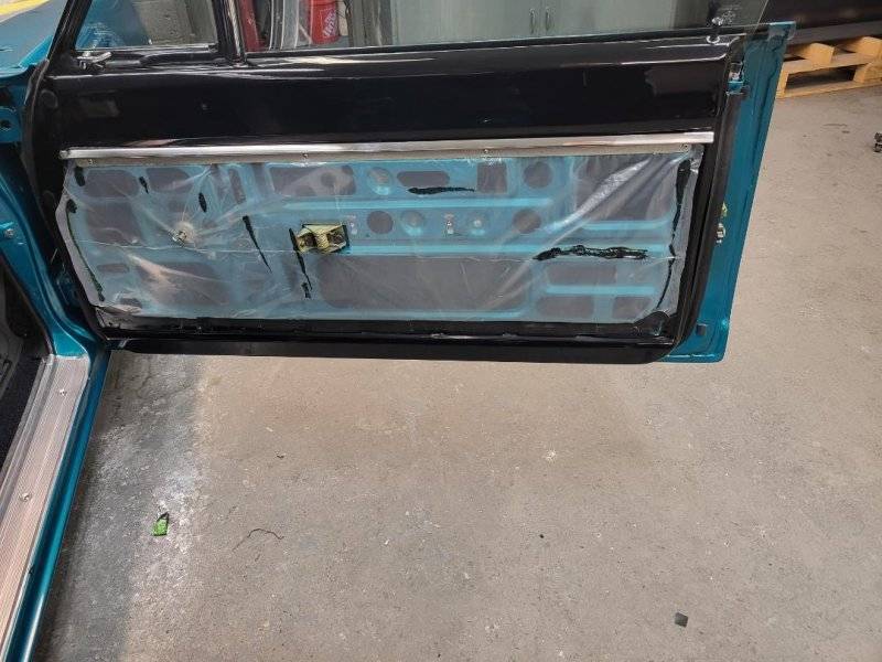

Meanwhile back at the ranch..... these are the inner doors of the '68 before being sealed up with their upholstered door panels. Note the drilled out window crank arms and very carefully trimmed inner door skins. The main rooster wheel can not be seen in this picture, but trust me, it's got a few ventilation holes. Looks factory ahh? Removed about two pounds per door and the windows slide up and down with no effort at all. Don't laugh, every ounce counts where it counts.
Meanwhile back at the ranch..... these are the inner doors of the '68 before being sealed up with their door panels. Note the drilled out window crank arms and very carefully trimmed inner door skins. Looks factory ahh? Removed about two pounds per door. Don't laugh, every ounce counts where it counts.

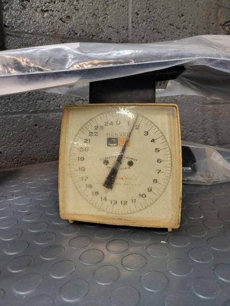

Meanwhile back at Area 51's skunkworks with the mysterious Dodge. A finished and now functioning door striker in T-7075 aluminum in comparison to its stock sibling on top.
Stock types weighed 3/4 Lb each. Aluminum types 1 Lb for both. Shaved 1/2 Lb.
Why so little?
T-7075 has a modest amount of titanium, chromium, copper and other alloys in the mix aside from the aluminum itself that make up its strength. Since installed after this picture, they have been coated with a thin layer of zinc phosphate color and a tint of yellow/green transparent spray paint to give them that stock cosmoline look. Only the strike marks underneath the teeth reveal its true DNA.

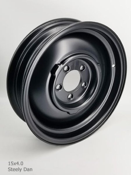

I changed out my front tires yesterday I took the stock steel wheels and tires off and replaced with vintage direct bolt cragar SS 4” wide . It took 19 pounds off the frontend I did it more for looks than anything else .
Wow, that's a very decent amount of rotating weight removed. Pays high dividends on all sectors of a pass. I guess the spacing between those iconic spokes on SS's and the slender 4" rim width cuts down on the lard.
My replacement of aluminum centerlines smoothies with a more stock looking (steely Dan's attached below) aluminum wheel actually added a pound or so over the centerlines, but still lighter than a real steel wheel. I'm happy with the relatively light health and stealth since I'll find the pound or so elsewhere.
My replacement of aluminum centerlines smoothies with a more stock looking (steely Dan's) aluminum wheel actually added a pound or so over the centerlines, but still lighter than a real steel wheel. I'm happy with the relatively light health and stealth since I'll find the pound or so elsewhere.
