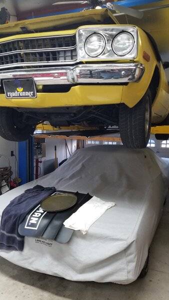

The transmission swap is going slowly. First of all, removing some of the bolts out of the bellhousing has been more than difficult. It's easy when the K member is down and the whole assembly can easily be reached! But when the body of the car, headers, torsion bars, etc. are in the way, it gets harder and much slower to get them out.
Additionally, we have had some bad weather here. I don't have enough room for all my cars, so I have to stack my 73 and 70. I don't want to leave the 70 outside in bad weather to work on the 73, so I need to have good weather to continue with the work (no rain or snow).

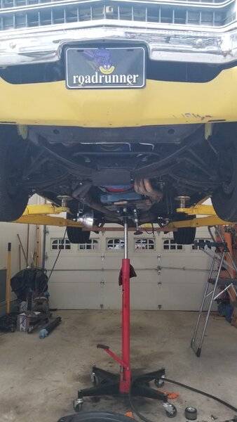

Hell, I've removed a few transmissions in my day, and with a lift and transmission jack, it should be simple. Right?
Well, in simple terms, this job is kicking my a$$. This normally happens when I get quite confident in my skills - call it Karma or Murphy's Law. :(
Basically, the Gear Vendors unit is making this job extremely difficult.

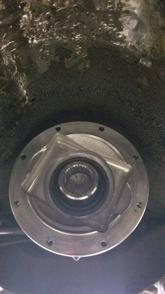

So I got all needed bolts, linkage, etc. loose and/or out. I then removed the GV overdrive unit from the back of the transmission. The problem is that the back of the GV tail shaft is not narrow like the original 727, but rather it has an almost 7" flange on the back. OK, well, I figured it might just make it out if I angle the transmission correctly as I take it out.
So I got my transmission jack under it and started messing around. My buddy and I lowered the front of the transmission hoping we could just sneak the tail shaft out.
NOPE. There is simply not enough room between the body and the torsion bar brace to get it out.
So then I figured: Fine, I'll just remove the tail shaft from the body of the transmission and take the transmission out without the tail shaft.
NOPE. The tail shaft cannot move back far enough to give the output shaft the ability to angle downwards as much as needed.
I'm stuck! :mob::cursin:

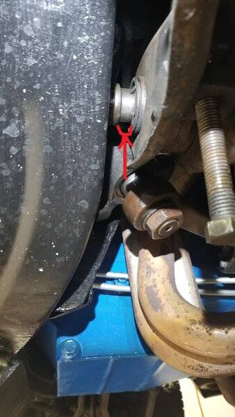

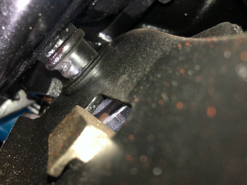

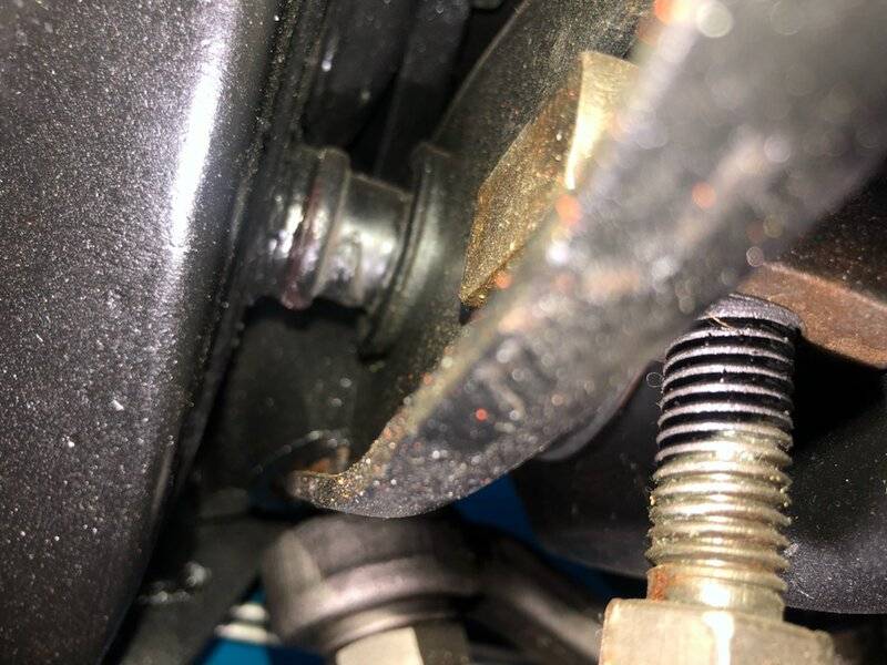

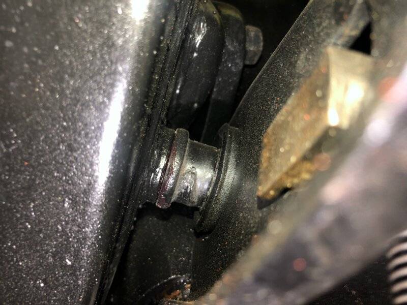

Finally, as I was looking up at the lower control arms the pivot shaft doesn't look like it is fully engaged in the lower control arm, but for the life of me I can't remember what it looked like after I pressed them on. Does this look OK? Should the gap (see red arrow) be there?
