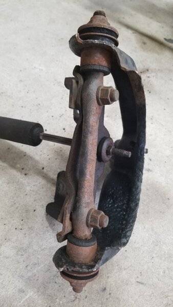

So I think I mentioned a strange "thunk" sound that started from the front right of the car. I finally got my car back on the lift to check it out.

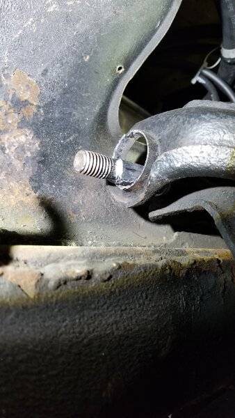

See something wrong with this picture?!?![]()
The nut, washer and bushing are gone from the rear of the upper control arm! The front nut is also loose, but that hadn't come off yet.
Was it me or the alignment guy??? (I remember tightening these, becuase pressing the bushings on was a pain, and we had to clamp the bar/shaft to tighten the nuts.) Sigh. I guess it doesn't matter because it has to be fixed regardless...

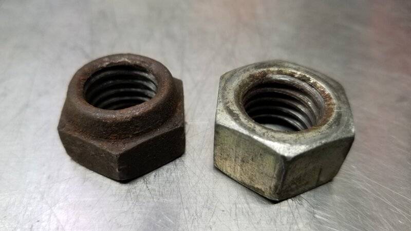

I have another 5/8" nut (shown on the right), but I'm not sure if there is anything special about the factory nut (shown on the left)
Anybody have any insight about the nut? Anything special about it?

A 73 is different than the earlier units, so it does not have the eccentric bolts, but rather a shaft that gets adjusted. I believe when it got aligned, the alignment tech did not tighten down the nuts that hold the washers and bushings in. So one came off and the other was very loose. The driver side is fine. Buy yes, you better believe it - I will go over each nut and bolt in the front suspension to verify they are tight and in good shape!WOW …..Your car was very kind to you…. It kind of looks like the threads on the original nut may be either soft or starting to fold in if that makes any sense. I would suggest getting the complete eccentric bolt and nut kit and double check the other side and everything else as well. Pictures truly are worth a thousand words.
