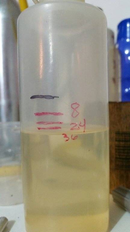

Here is my fuel experiment. I filled this bottle with fuel, black line is start of experiment and after 8, 24 and 36 hours you can see where the line ended up. So this just shows that with out adding extra heat fuel will disappear on its own via evaporation and about 25% in this experiment was gone after 36 hours. So, if you have a hot engine with a carb full of fuel, shut it off and have heat soak and carb with open vents, its no surprise that the fuel totally disappears. Even with the cap back on after 36 hours, the fuel is still evaporating.

That pretty much settles it, least to my satisfaction.
Hey wait, what percentage alcohol is your gas in this experiment?

Ours is up to 10%, and I think that's why the initial evaporation was more rapid than the later, I think that was the mostly ethanol going bye-bye!
One question about your experiment. Did you leave the cap on (with just the small open nozzle) to simulate the smaller vent opening in the carb? Obviously I didn't, mine was in an open plate the the evaporation surface was much greater. If not, I may try to duplicate your experiment while trying to keep the evaporation opening somewhat similar to what is on the car to get a more accurate indication of the actual evaporation rate...................unless you want to.
I did this with the main cap off, which is about 3/4 inch in diameter, which just so happens to be about the total diameter of the 3 vents on a thermoquad as each is 1/4 inch, so the area is roughly the same.

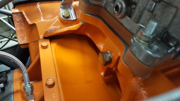

Here's one for you. After running the engine up to operating temperature yesterday, I shut her off and about fifteen minutes later I noticed this.
Carburetor must have been leaking down and found a gap in the intake gasket. I pulled the intake and installed one paper gasket above the tin pan. That took care of the intake leak, now to find out why the carb was leaking down.
After this last startup, I readjusted the carbs and they tuned in a little better than before. (No vacuum leak now) I've been watching down in the carb and so far I haven't seen any gas trickling.
This can be a reason why you would be loosing gas, all I have to do is figure out what's causing it. Don't need the cylinders getting washed with gas, though I've never had a rich condition when fireing it up either. I'm thinking the float bowl overflowing after shutdown. Sometimes, after shut down, I'll see pressure still reading on the fuel guage and it slowly bleeds down over a period of time. Maybe some gas is getting by the needle and seat? I have totally rebuilt both carbs and will be installing new jets in the near future so I'll test this out then.
