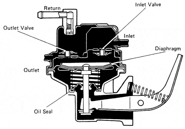

I believe the question in this instance is can fuel flow backwards through an idle pump? We're looking at possible ways a carburetor can lose its' fuel when sitting idle.

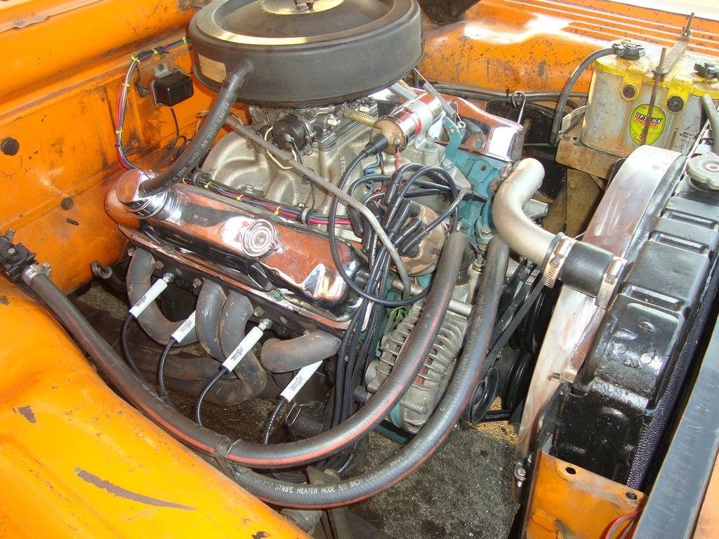

its a heat transfer thing , i've had to block off the heat raiser from the heads through the intakes . then a stack of gaskets and thin metal plates to get the heat away from the carb afb type weber . and run an electric choke on the carb .
In my last post I was asking when useing a electric pusher pump, say back at the tank, will gas flow through the idle mechanical pump?
The answer is yes, it will flow through a mechanical pump. I just checked a new stock fuel pump. I blew air through it with the leaver in the open position and then placed the pump in a vise and compressed the leaver and air still passed through it.
Will gas flow backwards through it? Yes, but how is gas going to flow back to the tank when the line goes up near the top of the tank?

its a heat transfer thing , i've had to block off the heat raiser from the heads through the intakes . then a stack of gaskets and thin metal plates to get the heat away from the carb afb type weber . and run an electric choke on the carb . View attachment 512736
I do wish the engine builder for mine had used the intake gaskets that block off the exhaust crossover. From what I've read, some of these 440's are hot natured to begin with and I certainly have one of those, given the steps I had to take to tame the cooling system.
The pretty paint job the builder did on the engine is now a cooked, flaky mess on the crossover ports in the stock intake, so it's obvious the crossover isn't blocked off.
I do have a good thick insulating carb spacer under the Edelbrock/Weber/Carter clone AFB anyways (I've gotten into that habit with all of the 440's I've fooled with over the years, usually to get clearance for the choke linkage on aftermarket carbs).
I don't have the full blown shield type "apron" under the carb, though.
In the end, I guess the consensus is that the ethanol-poisoned gas is being "boiled" (actually evaporated from heat soak) right out of the carb and the AFB is more susceptible to this event than the Holleys are, due to the location of the bowls closer to the heat source.

My 440 got so hot during break in (guessing from the exhaust) that it melted 2 of the black plastic push pins that attach the inside firewall insulation and 2 of the plastic clips for the washer hose.
I just don't get this. If gas can flow backwards, how does it ever pump up to the carb? When the inlet valve is open, the outlet valve is closed, and vice versa so fuel cannot reverse flow. What am I missing?
Pressure from the elec. pushes the check valves off their seats a little. Maybe not as far open when diaphragm is moving, but enuf for some fuel to get by.

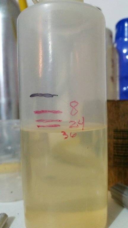

Here is my fuel experiment. I filled this bottle with fuel, black line is start of experiment and after 8, 24 and 36 hours you can see where the line ended up. So this just shows that with out adding extra heat fuel will disappear on its own via evaporation and about 25% in this experiment was gone after 36 hours. So, if you have a hot engine with a carb full of fuel, shut it off and have heat soak and carb with open vents, its no surprise that the fuel totally disappears. Even with the cap back on after 36 hours, the fuel is still evaporating.
I'm thinking it's mostly the ethanol that's evaporating too. Once that evaporates then the rate would slow some.
Thanks for the science class :thumbsup:
I totally agree with that assessment regarding the ethanol, my questions is then, how much does the volatility of the fuel decrease with evaporation.
Kind of confirms my experience. Sitting one to three days starting is no issue. Sitting a week, or longer requires some cranking.
