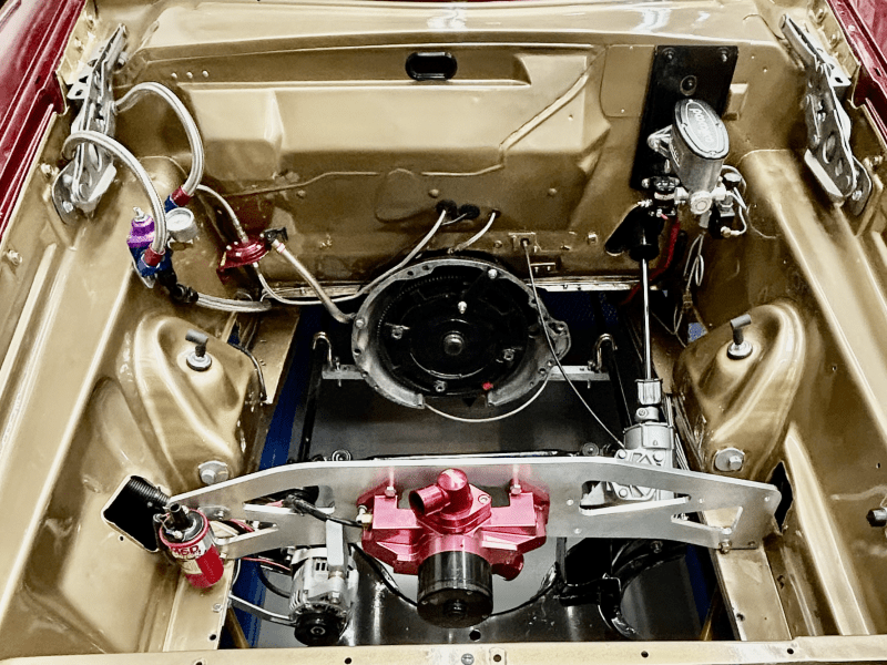

But the rest of the list is wrapped up. And I did end up finding 53lbs, all of it off the front - glass hood included. Although the HardBlok put some Lbs back in. Will still meet my 3200Lb less driver with fuel target.
Tidied up electrical and some other areas. Was eyeing the firewall reinforcement plate, but it dodged the cut for now.
Steering column got very lighter.
Electric shift addition for ‘24.
That’s what’s shaking in my camp this off-season. Even pounded the oil pan back out straight again.

Love your transmission support for when the motor is out of the car. Great design using the torsion bars.
