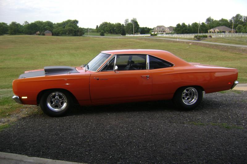

here is my 69 gtx im running 18-10s in rear and 18-8s in front.
I like it Barelad, that floats my boat. Now, 20 questions. (Same questions for you Darius)
What size tires on both ends?
What are the offsets on both ends?
Did you have to do any mods to the rears to stuff em under?
Do you have a closer shot of the bottom pic, more of a full side view?
im running 275-40s in rear and 235-40s in front and the rear has a 4.5inch backspacing and front have a 3.5inch backspacing. and no mods they went on perfect.

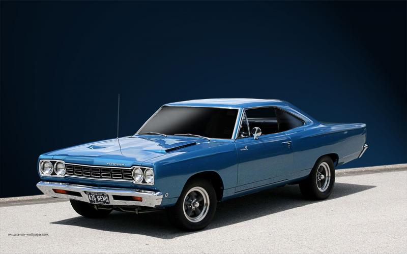

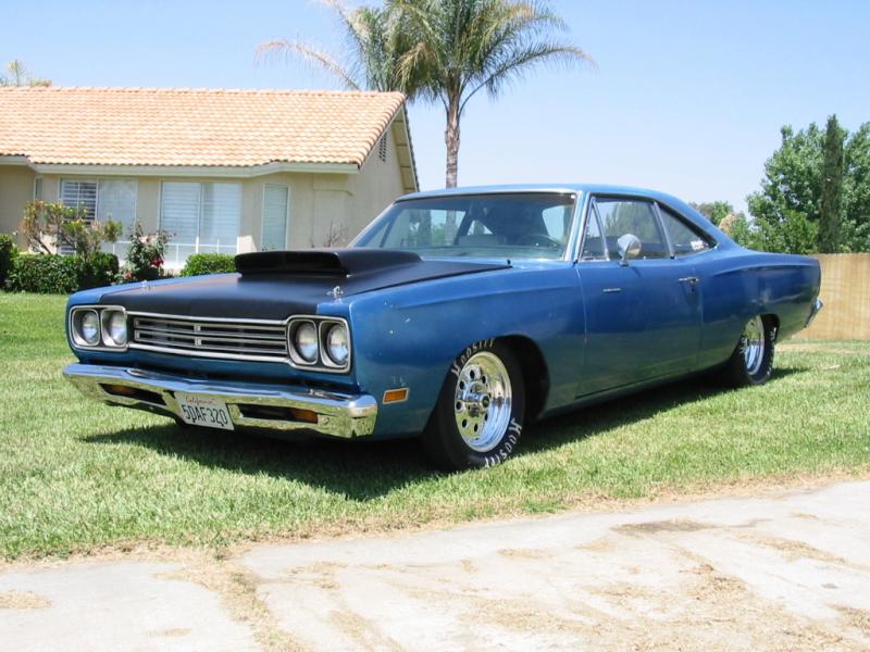

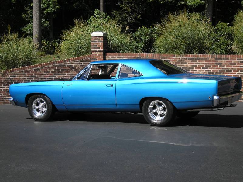

here's a couple more I found, all types & stances 1968 RR's
ok here's a few 1969 RR's, all different types, a couple 69 GTX's too
I'm sure you will recognize a few from here, reg. style or traditional skinny fatty, low cars 17"-18" wheels & even some possibly bigger, different stances &/or different brands/style, pro-street to drag car to street cars... even one from Need For Speed video game

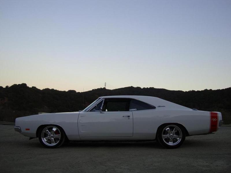

It's impossible to please everyone so just go with what you like. I like the 15" wheel look but I think the 17-19" wheels fill the wheel well a bit better. I went with 18x8 and 18x10 on my charger and love the way it looks and handles.
Sweet Charge, the chin spoiler looks really good too.
