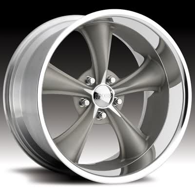

Thanks 747, well aware of the costs and custom backset approach which isn't a factor. I'll do what I need to for the look I want. Most of the nicer rims offer 3 or4 different backsets without going the custom route. Those fitment tools are great but they don't tell the whole story, like section width.If you want to nail the fitment down and max out the wells this is what you need, it allows you to see how any given combo will fit. I'll go ahead and warn you now on the pricing and fitment, if you want a set of wheels for a fair price they are usually going to be cast aluminum 9.5 wide with 4.5 backspacing for the rears (one size fits all). When you start wanting different widths and offsets you mostly go into the made to order billet wheel makers with the prices being north of $500.00 each. A good wheel for you to look at since you like the Torue Thrust look is the Boss 383 "pretty cheap and nice". Good LuckView attachment 156581View attachment 156582
