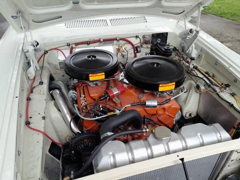

- Found a forged crank for the new engine build I'm doing. It's an original 426 wedge unit, standard and will probably clean it up 10/10. A friend had it squirreled away. Need to source new pistons, rods and rings and then I'm off to the build.
- Put a good compression gauge on as I almost blew my finger off rolling the motor to find #1 TDC - I suspected that I had more compression than I bargained for. 205psi - that works out to about 14:1. I suspect that the MW heads have been milled, I'll CC the chambers when I do the new engine build - these 286 heads are the early ones and should have been around 81cc's. That was with a 0.051" head gasket too on a 0.060" overbore. The pistons are zero decked. Oh well, it's airboat country here and AV gas is readily obtainable and not that much more than the 94 they sell. Sounds REALLY healthy, really pops.
