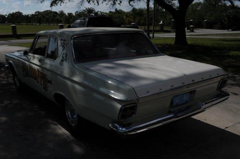

Updates:
- Took the car to the gear shop this last Monday morning per our agreed upon drop off appointment. Shop would not return my calls or give me an estimate on the work. This afternoon, I called them and was told that they had not got to the car yet for anything and wouldn't until next week. I told them to get all my parts together and I'd send a tow truck to pick the car up. I was sensing auto shop jail and I'm not playing that game especially when I was told they would get right on it as agreed. It looks like I'll be dusting off my differential tools and doing the gear and spool swap to a sure-grip D60 diff myself. I know they are a busy shop and I'd used them before on small stuff but I made the call to get the car and my parts and do it myself unless I can find another shop to do the work on my time line. I would like to debut the car next year in March at Bradenton for the NMCA/NSS 2023 kick off but I probably won't make it but I'm going to shoot for that. Car and parts are home now.
- Drove the car up and down the street for a few hundred yards, felt good. Needs tuning big time.
- Put the antique plates on the car and it's insured, so as soon as I do some tuning, I'll go for a good drive after the front end gets aligned and a new exhaust system with cut outs installed.
- Got the new RCI fuel cell sender from Summit to replace the defective one, install later this week but my meat hook hands are too big to fit in the hole, so my buddy with smaller hands will have to assist me with that job.
- Got the new inner/outer sill plate sets delivered, mine are the worse for wear so I bit the bullet and got new repros. I'll post some pics.

Updates:
- Got the new RCI fuel cell sender installed - all good now. The old one's lever arm was stiff but the resistor and float is good, I'll keep it for spares.
- Powered up the car and the brake lights were on. Pedal was high and stiff. I initially suspected the line lock I tested out yesterday but I cracked the fitting at the line lock inlet and the brake lights went off, so I know it's not a sticking line lock solenoid. It has to be the adjustable brake pedal rod is out of adjustment. Now I get to do one of least favorite things and adjust it. I replaced the master cylinder with a different newer model and I though it was ok with the way it was but NO.

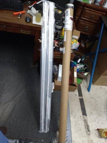

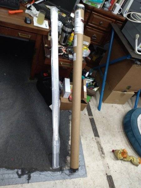

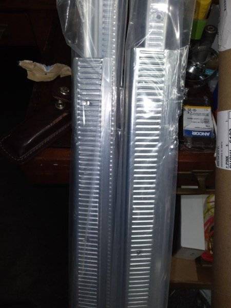

- See attached pics of the resto sill plate sets. They got shipped to me from Classic in a heavy duty tube, I'll be saving that. These are nice pieces but they don't come cheap ($279.99 + $38.95 shipping), I saved some $$$, Trim Parts wants $360.89 + $47 shipping for the same thing.

Updates:
- Finished the brake push rod adjustment. It SUCKED just like I thought it would/remember but it was WAY out of adjustment. Everything appears to be OK now. Luckily I had installed a MP adjustable piece 20 years ago, so with 1/2" & 9/16" open end wrenches, I got it done. My neck is going to be sore for a week after the contortions.

Updates:
- Made the paint shop appointment last week. It's going in some minor body work, cowl rust repairs and a fresh coat of WW1 Ermine white the first week in January (January 2nd).
- When I did the front end this last year, I could not find a Moog pitman arm. Now I have a nice NOS one, so I'll be pulling the old pitman arm and installing a new Moog pitman arm. Removing pitman arms has always been a PITA for me, so I invested in a new OTC 7310A puller. This puller is a beast and I anticipate no problems with pulling a pitman arm ever again. I replaced the supplied 5/16-18 4" bolts and wingnuts with Grade 8 parts and this should cure any complaints/reviews that I ran accross. All those said when they went to better hardware, the puller worked flawlessly. We'll see. The puller also comes with adapters for use when popping ball joints.

Updates:
- Changed out the Pitman Arms - what a piece of cake with that OTC 7310A puller. A few seconds and it was off with an impact. I've fought Pitman Arms for three days before I won. Worth every penny
- Trying to find a shop to do the front end alignment this week.
- Got a small leak at the shift cable entry. Probably need to change out the cable o-ring. I'll do that after I get the FE alignment and exhaust done.

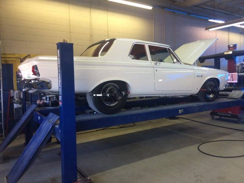

- Had the car towed to the Okeechobee Dodge dealer for a front end alignment - they were stoked to see it and asked for the job. Very gratifying to see the techs go over the car when it was dropped off.
- While at the dealer I asked about the gear and sure grip change out and for an estimate. They are competitive with other Okeechobee shops, so I gave it to them. Unfortunately the tech that was most qualified came down with a 102* fever and has been out since then but will be back in this Monday (12/5/2022), we'll see. The guy really wants to do it, so I'm willing to cut them some slack - they are fired up about it, so I'm OK with paying it forward though I hate leaving Max anywhere overnight.
- It makes me feel really good seeing the techs reaction to the car. When they see the flat hood come up and the crossrammed engine comes into view... that's payback enough for me. The service managers and sales guys are really into it... I got a call from the sales department asking if I was interested in trading it in.... HA.

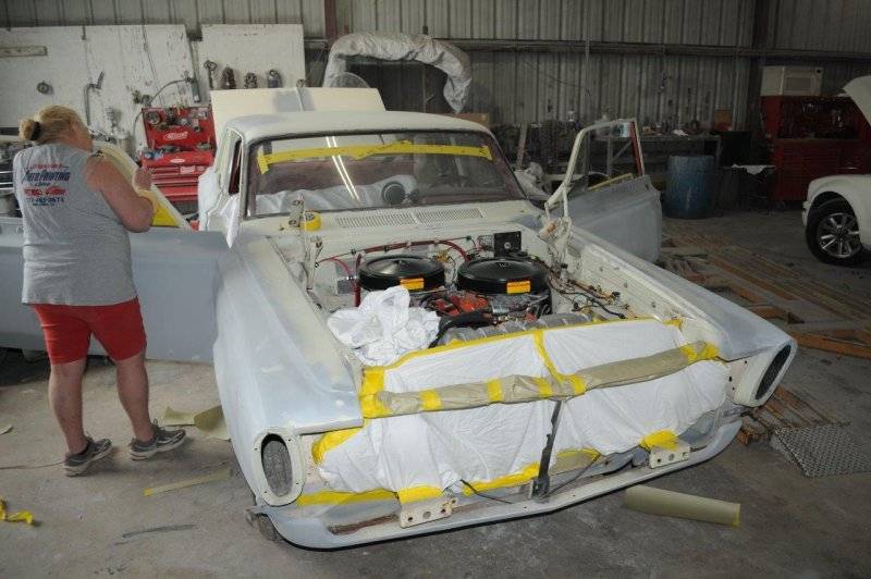

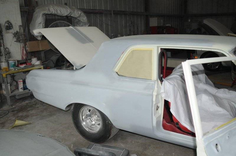

- Stopped by the paint shop to see progress, getting masked up and ready for paint in the next few days, see pics
