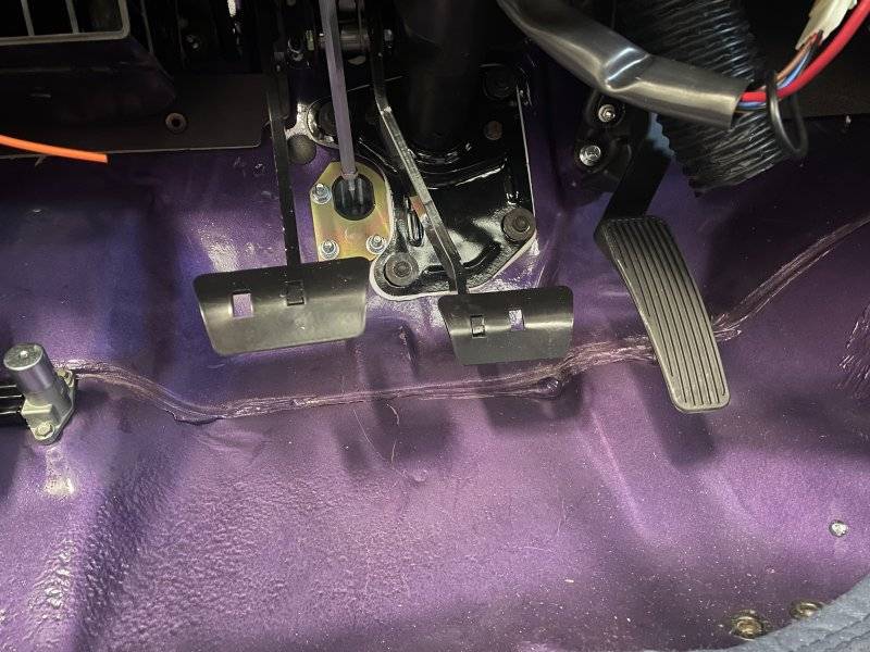

Sounds like the old "we do it right, cuz we do it twice" model. I'm always reassembling something and realizing I need to take it back apart. It goes easier the 2nd time!The problem was that the complete drive-by-wire gas pedal assembly has to be mounted to the firewall versus the stock arrangement that wouldn't have the pedal in place, since the carpets aren't installed yet.
If it ain't done more than once it wasn't done right.Sounds like the old "we do it right, cuz we do it twice" model. I'm always reassembling something and realizing I need to take it back apart. It goes easier the 2nd time!

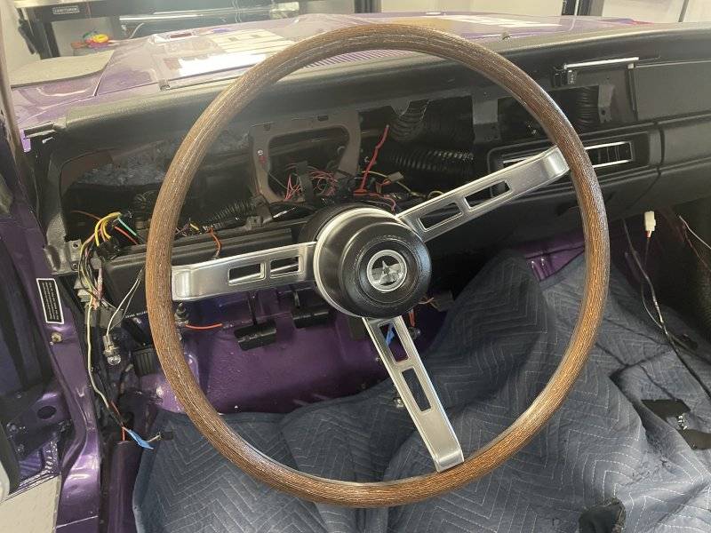

I went down that same rabbit hole as you. I was told by Chris at Hotwire that the stock ignitions had a break in continuity between start and run that the Hemi didn't like and that I needed to add the push button. I pulled my ignition switch and tied the start and run positions together thinking I could then use my stock ignition. It worked about half of the time. It would always start but not always run properly. It would stutter and flutter & generally act like it had no idea whether to run or not. I finally broke down and added a push button which solved the issue. Still have no idea why.The wiring directions that come with the MP kit on how to wire it into your existing electrical harness are a bit vague. There are actually not that many wires to connect, but the wording in their directions leaves one scratching their head. I was told that a separate starter button is needed, but didn't understand why. The answer is because one of the MP wires needs to be hot when the ignition is turned on and also when cranking, and this is something that our old ignition switches can't do. hence, the need for a starter button. This should be put in their directions. Seeing that most of these kits are going into a 60s-70s old Mopar, you'd think that they would give you that additional information instead of leaving it up to the user to figure it out.
I know that Holley makes a kit of their own & I wonder if theirs needs a starter button as well.
