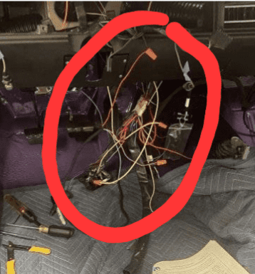

Making electrical progress little by little. All exterior and dome lights work.

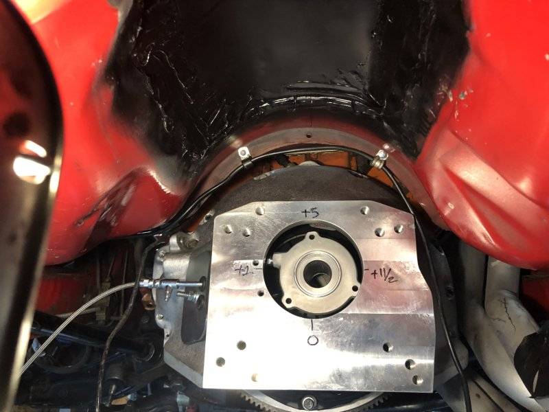

The TKO of mine had a speed sensor on the right side of the transmission. I ran the speedometer wiring over the trans tunnel and had loops attached to the pinch weld.

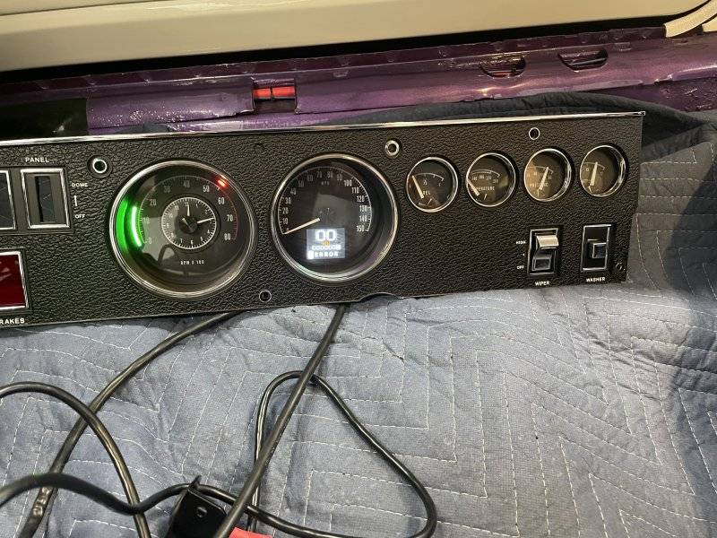

I just have to confirm where they go on the Dakota box. Their directions spell out ground, signal and power. I was told to use ground and signal, but neither of the Speedo wires grounds.
I also have to see where it gets signal to be backlit when the headlights go on.

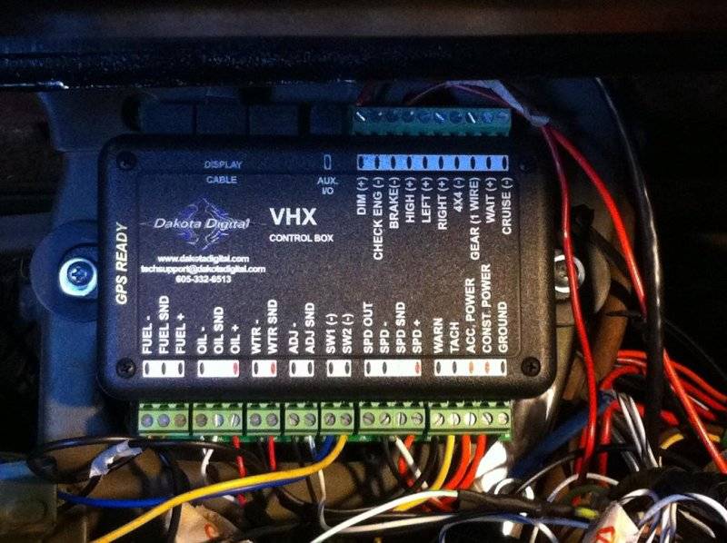

Did your gauge setup include a box like this?
Bottom row, to the left of WARN/TACH/ACC Constant power
