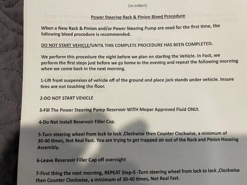

lock to lock 30-40 times.......twice
sounds like a work out to me
sounds like a work out to me![]()
I wonder if brand new cars on the assembly line have to be rotated 30-40 times like this?Got the new hose in the other day & I just got the ends crimped on a couple hours ago. I'll put it all together tomorrow morning & start the process of bleeding the rack as per Bouchellon's instructions (which I didn't have before).
are your arms tired?
Both way he takes Geretol!are your arms tired?
Replaced the rack on my 95 Dakota beater probably 15 years or so ago and well, filled up the pump, started it, turned the wheel a bit, checked the pump to make sure it was full and didn't have air in it and drove off. And I'm sure the factory has a system to get them right but have heard some stories about crashes when the cars came off the line and went into the 'test' cell. Some of the stories were when the test cell run was complete lol. Btw, that replacement rack is still doing fine but is starting to get some play. What can I say.....China made but it ain't leaking like the original did when the truck was about 12 years old.Got the new hose in the other day & I just got the ends crimped on a couple hours ago. I'll put it all together tomorrow morning & start the process of bleeding the rack as per Bouchellon's instructions (which I didn't have before).
