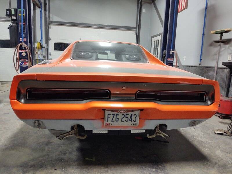

I pulled the Charger into the garage to fix the rear passenger side valance corner (I backed into something) and fix where my wife backed into it (fortunately the same area) but.....
I had side exit exhaust which has been a real pain living in the country so no better time to modify the rear valance for rear exit like I've been wanting too... here comes custom made 3" stainless exhaust from the mufflers back. That uses up the area where the reverse lights go so now another mod to add better lights.

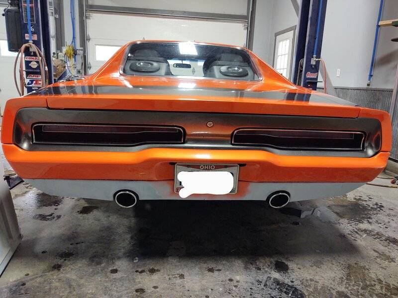

Here it is, first time assembled after the metal work on the rear valance. I'm liking it!
Very nice mod, as usual! We need some audio!

I think I'm liking this idea? The plan was to make a discreet reverse light panel that would also hide the fuel tank but the discreet part proved to be the challenge. Think I finally got it tucked under enough with the flat black paint that it will get it done. 2,000 lumens worth of LED's, should be an improvement.
