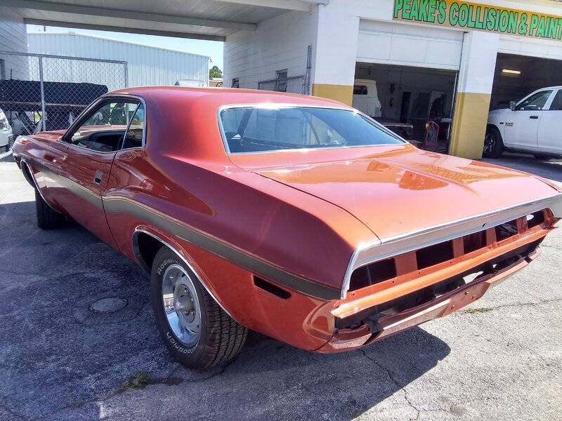

Here's mine.
Congrats and glad you're happy with it. Bottom line is that's all that matters
Now that's what I'm talking about.....
I Love it. I'm going the same way, but different color.

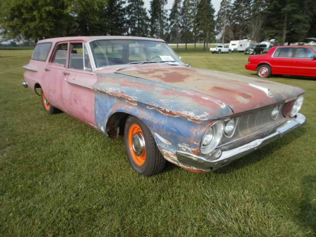

I purchased my '62 in 2015 and started my first (and last) "restoration", which was being built to "driver-quality" standards (on a budget).
I removed the drivetrain, exterior trim, interior, dash, glass, etc. The body was not stripped or blasted. I did as much prep and body work as I was capable of (wish I'd done more) and took it to my local MAACO shop.
I told them exactly what I wanted and they gave me a quote, which included extra charges for several small repairs (patches) on the body and painting the engine bay, door jams, and steel wheels. They also mixed the code F Pale Jade color I wanted right there (base/clear).
Long story short, I was "out the door" for about $3,200. Am I happy? Yes! Is it perfect? No! Advice? Know what you want (expect) or buy 'em done!
View attachment 868628 View attachment 868629
