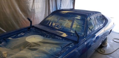

That said, On my car. Went for a 2 stage. Paint and hardener, no clear coat. I didn't want to over restore. Urethane. Paint at the time cost me around $900. Including a sandable primer-. a very good thing. Get to that later. So you know what he told me. Original paint, dull. But, sticks to the body. Just needs to be skuffed up, issues on paint that need to taken down to bare spots need to be painted with an etching primer 1st. On rusty spots, need to be re-placed with new metal. I'm good with a MIG welder to do this.

Once painted, he showed me how to wet sand. Water, rubber squegie. Loose the orange peal.
By the by, painted the door jam, the whole door including internal sides, under the hood plus edges, and the engine compartment. I wanted concours and I think, a 95 point car out of 100 points. When done.

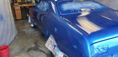

Wet sanding, Anyone can do this. Really nice paint job when done. But, Look close on the paint. Looks like an orange peal? Bumpy. No clear coat.
I wet sanded the car 3X. 1,600 some grit at 1st. Water bucket, wet sand paper and a rubber squegie. Dip the sandpaper in the water, small spots around a 8x8. See some bumps? Keep sanding till they are gone. Squgie to see. See a dark spot? That's dirt under the paint, stop sanding that spot.
Do remember, the sanding includes the lower part of the car. Once done, paint looks like chit ->dull. Then needs to be buffed out with 1,600 grit polishing coumpound and going to a 3,200 coumpound.
Back to the sand-able primer-> 2 stage. Body work is ok. What a sandable primer does.
2 stage, puts on a orange peel primer. You use 1st. 1,600 grit dry sand paper to sand it down to a smothe Then wet sand.
