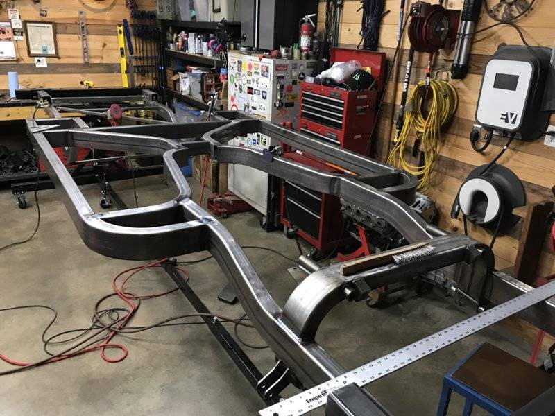

The Willomet Charger
Looked interesting, had to ask.

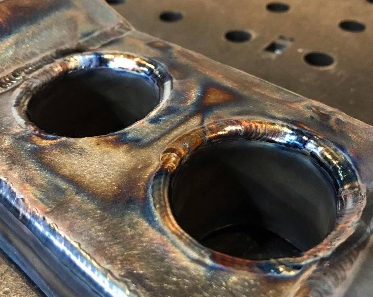

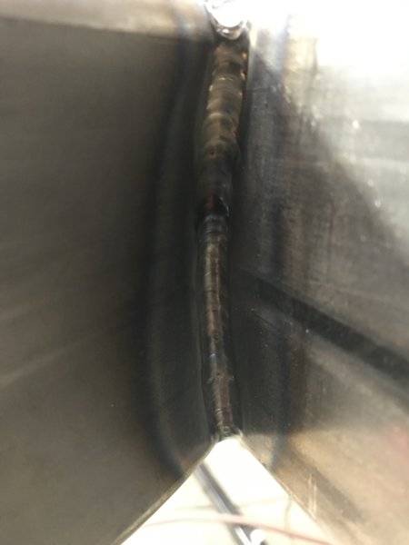

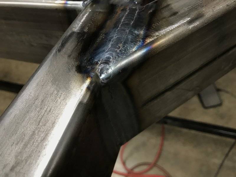

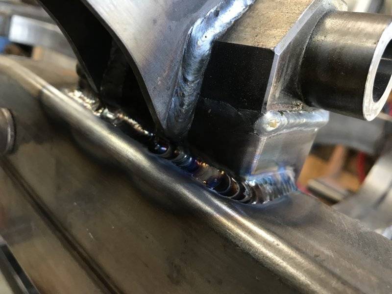

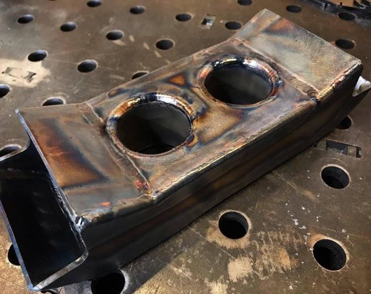

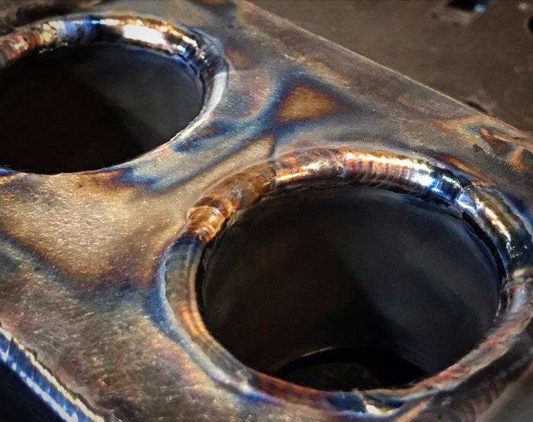

Cap passes are done, and it’s all still square. It actually does take all day for me to do this - all 150A pedal pulse.
Next up: probably enclosing the torque boxes to create jacking points. Maybe engine mounts.
David
nice heat penetration

Spectacular work David, as usual. very cool.
I was nervous since it had been 6 weeks since my last TIG weld, but a bit of practice on some coupons got me back in the groove.

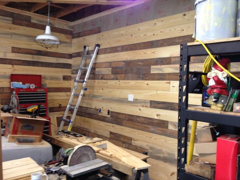

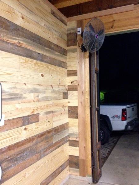

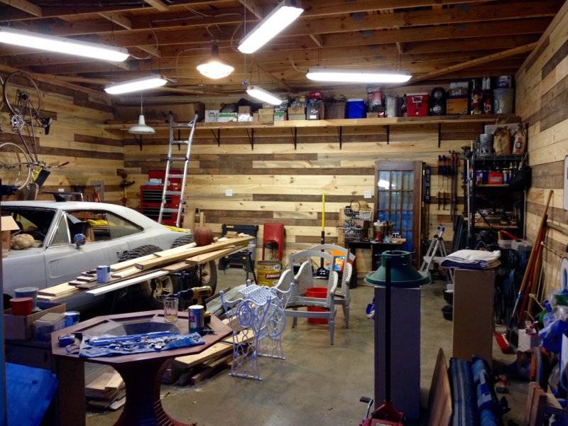

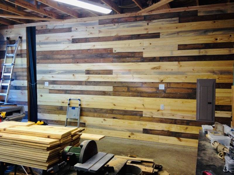

Could you post some pictures of your walls for me, I'm getting ready to finish my addition and love your garage. I've got piles of maple, cherry, walnut, hickory and ash laying around so wood is free lol.
Of course. It’s all 1x shiplap and flipped 105 siding - all pine, no stain or sealer, and aging nicely 7 years after install.

David's shop is always so spotless and organized....damn it.
Not always. It’s a space made for work. Cleaning and putting away are always the first and last things on the work list. I don’t work as well when it’s not tidy.

Thanks, that looks amazing! I know most will say it's terrible for lighting but hey... I like character and you can always overkill on lighting lol. Debating on whether or not to sheet it first just to minimize dust penetration and drafts, could just sheet it in plastic?
I tend to agree on the lighting. If I need more, I can install more LEDs. They're pretty cheap. I put in R19 batting into the walls, which sealed it up quite a bit. Alternatively, you could use Tyvek and skip the insulation if that wasn't needed.

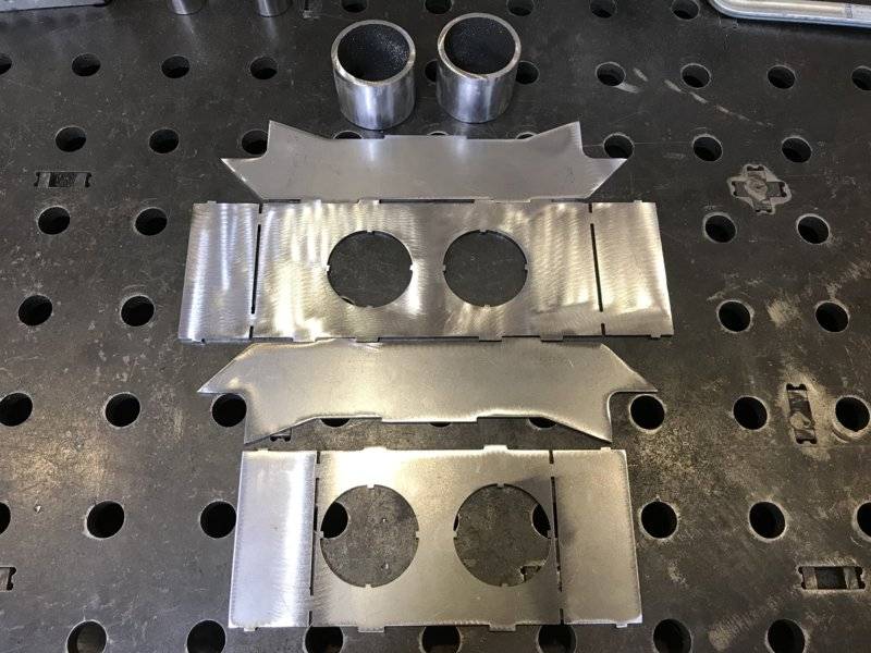

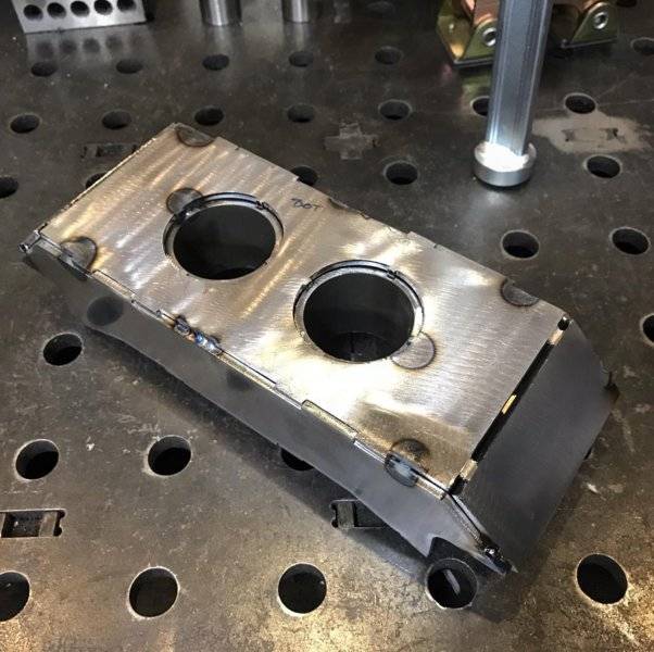

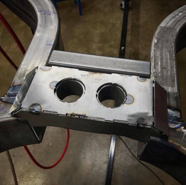

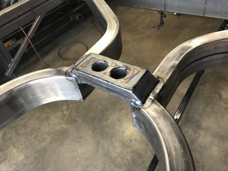

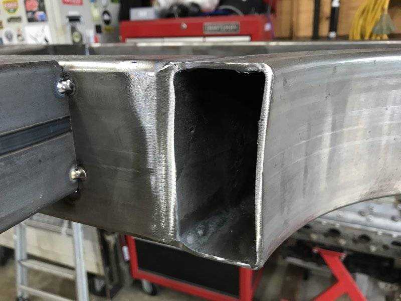

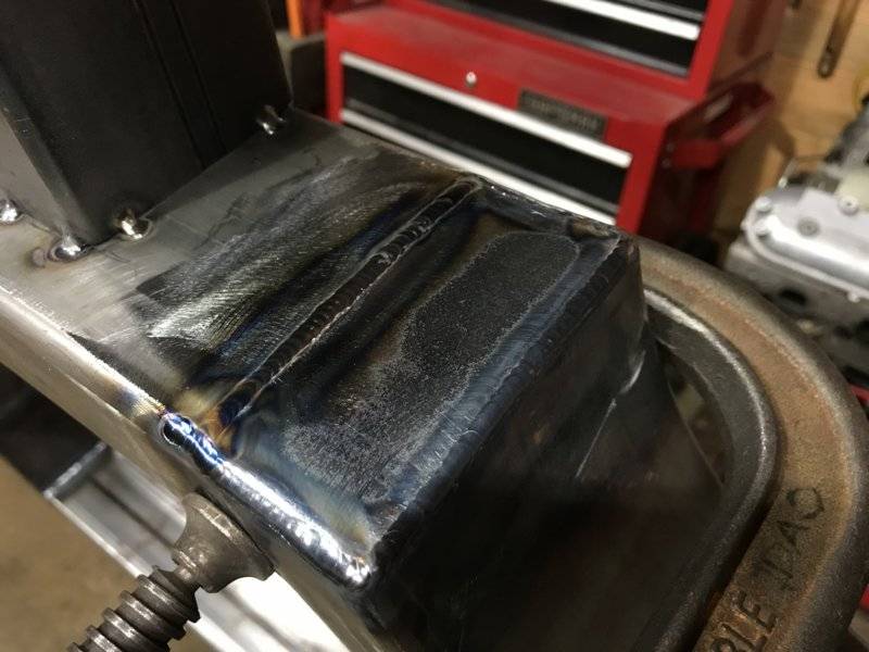

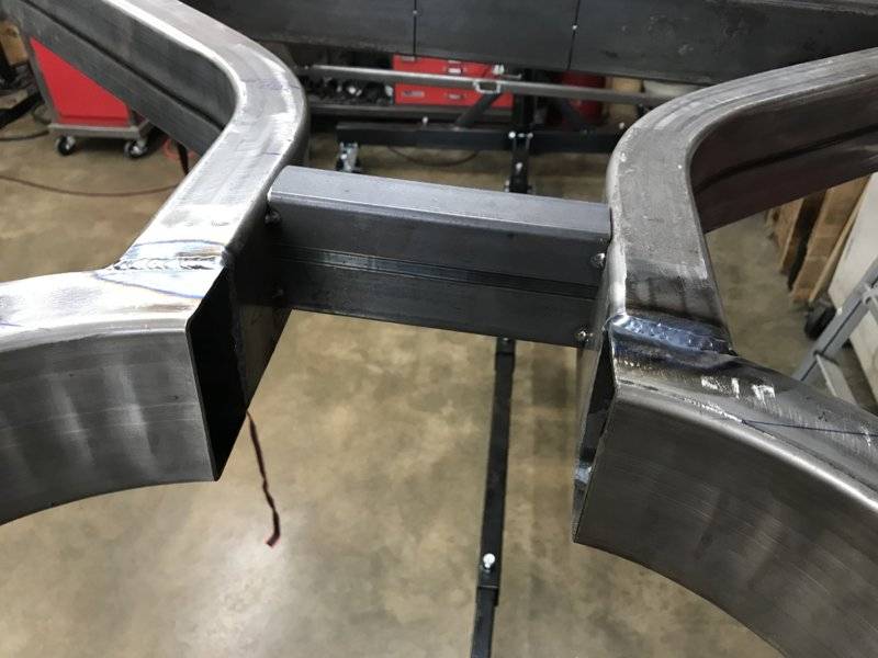

Working on the mid-chassis crossmember. Lots of welding still to go.
David
Really great skills there David. You can continue to color me jealous of them...
You should see the stack of garbage junk that precedes a finished part. A friend of mine calls that the, “tuition pile.”
Overachiever!!
I aspire to be one. Fabricating on this car is my therapy.

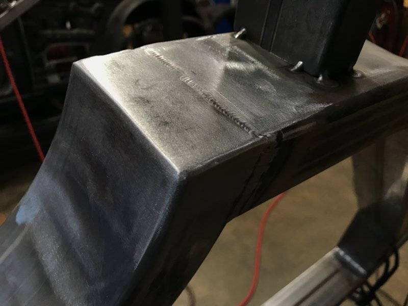

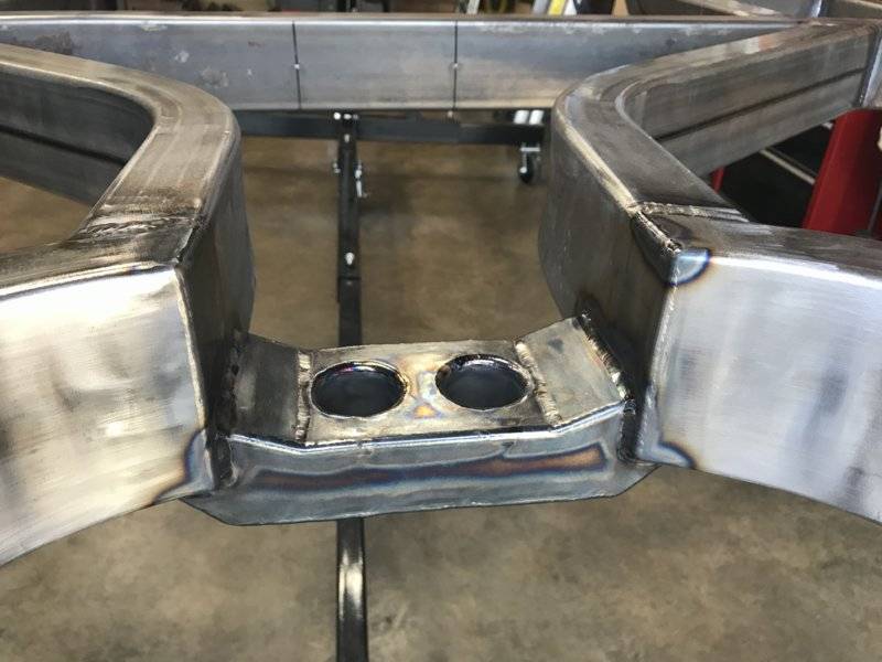

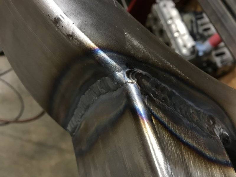

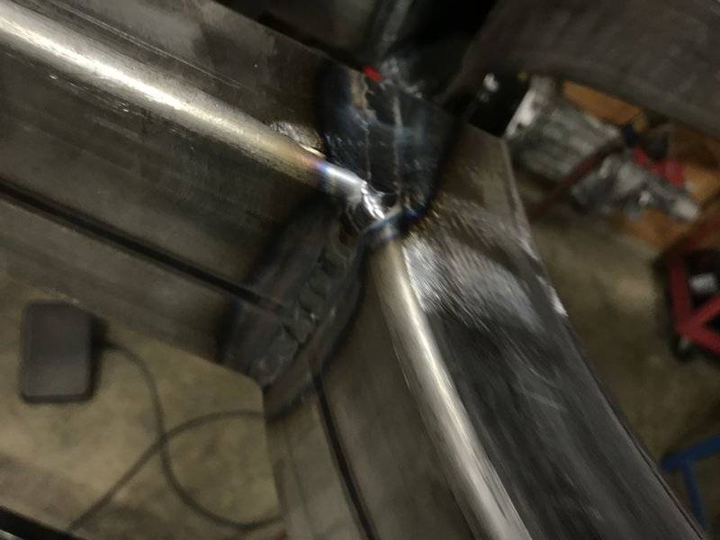

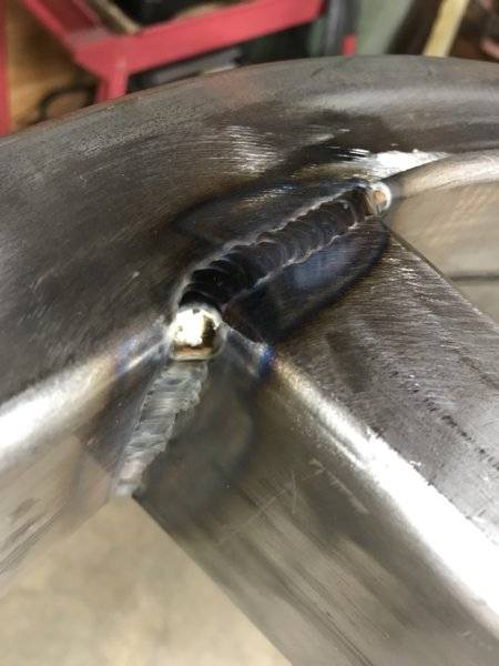

Saturday workflow. I did the root passes Friday night, capped this morning, and it’s actually burned into the chassis right now. I’ll cap those welds tomorrow, and get on toward the engine mounts.
